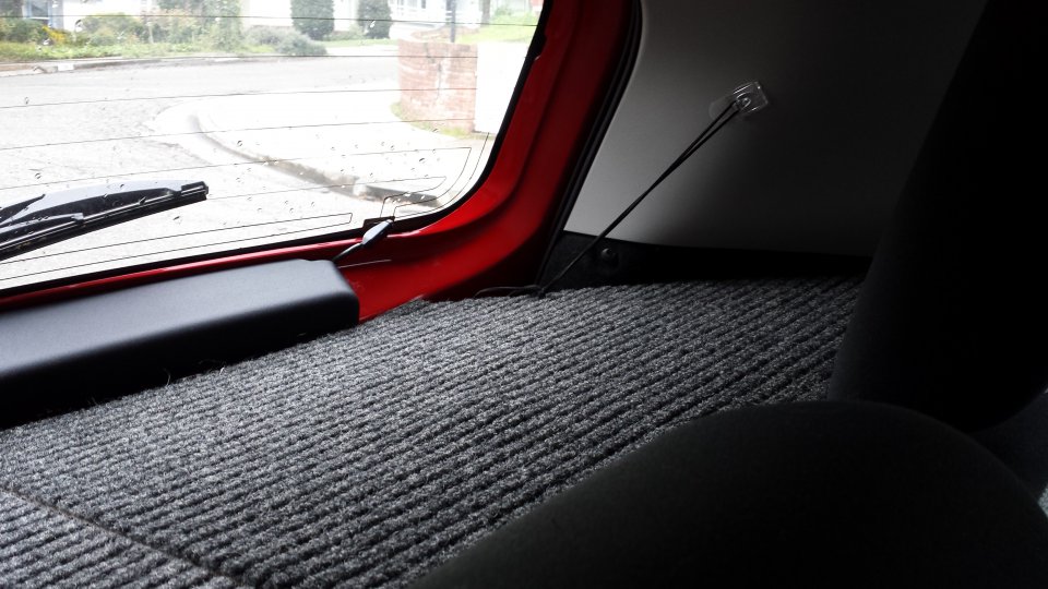

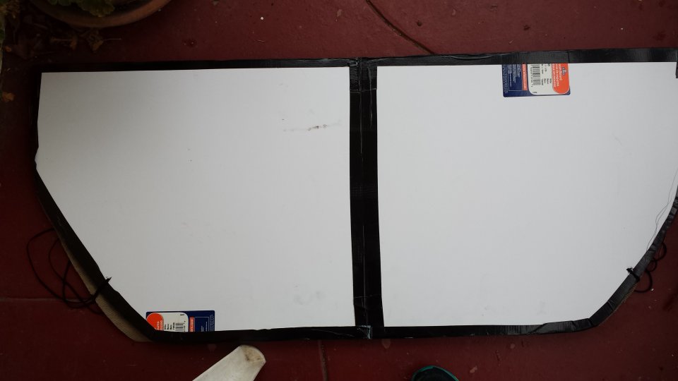

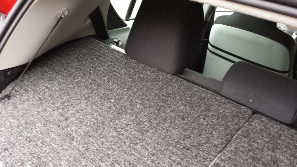

    I just bought an used prius c, and this was the first thing I wanted to fix. So I bought a 30" by 1/2" Elmer ' foam board at Michaels crafts, black duct tape, black cord, 2 $4 door mats and a pack of 3 damage free clear plastic mini hooks. I measured out the space and cut the foam board. I found that cutting them in half allowed me to fit them in the space where I can open it up. I used the black duct tape around the borders and on one side of the center seam to hold it together. Then I cut the floor mat and glued it to the top. I later punched a hole in the edges and strung a cord through it where it's tied to the plastic hooks I've attached to the car. It looks OK and the pieces only cost $30. Hopefully the photos will upload ok.

    that actually looks pretty good

    A A Martin, This is one of the best do it yourself projects I have seen on this forum. It is inexpensive, looks good and does the job. Great work!
