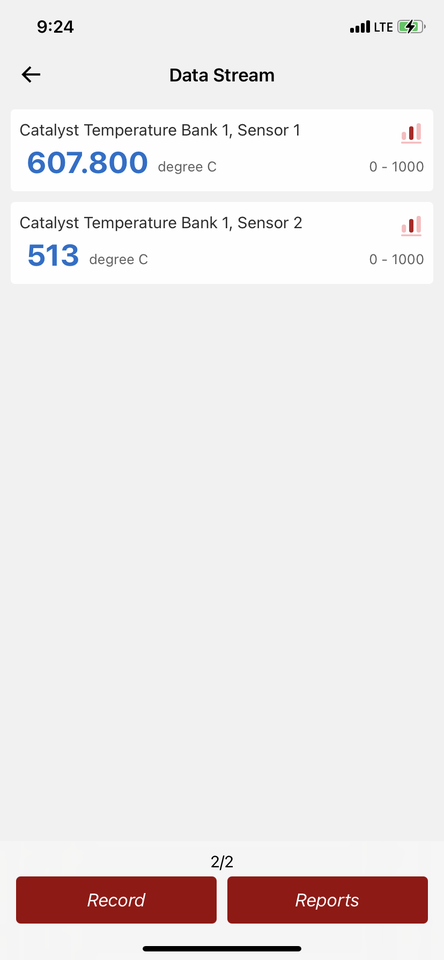

    When the spark plugs are faulty, they misfire, the fuel does not burn, but flies into the pipe. The temperature on the catalytic converter is high, it burns there.
