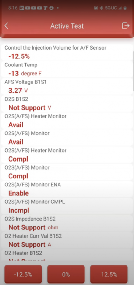

    I think I need to change the o2 sensor if I’m not getting a voltage reading.

  9. Mendel Leisk
    61,321
    42,200
    I thought a jpg might be easier than a video.

    Any suggestions on this other than changing the o2 sensor?
