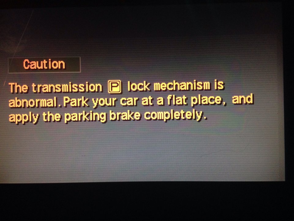

    No. The energy for running the parking pawl motor comes entirely from the 12V system.

    You don't happen to know how much energy it actually uses do you?

    I have the same issue. Just bought a 2004 Prius with 210k. It's runs and drives fine, just when I drop below 3mph the message appears. Also the red triangle never goes away.

    Your 12v battery is probably dying

    Sorry to bring back an old thread/hijack. But I am having the exact same issue as these guys. My fluids are full (coolant, brake, transaxle, engine oil). I recently did and oil change and transaxle fluid change hoping it would solve the issue but it has not. Anyone else have any ideas?

    If the 12V battery known to be OK, and the connections are all tight, and the car is not showing any other unusual symptoms, there is a small chance that the problem is with the Transmission Shift Control Actuator, which is the small 3 phase motor that drives the lock into the transaxle gears when the Park is engaged, or with the Transmission Control ECU which drives it. Quite a rare failure, but it could be a result of wire harness damage due to road debris or rodents. All speculation until the DTC are read.

    Do you think a Solus diag. Tool would be able to pull the DTC?

    Don't know. There are so many out there. Most likely it does not read the Hybrid Vehicle ECU. The Mini VCI is the best option.
