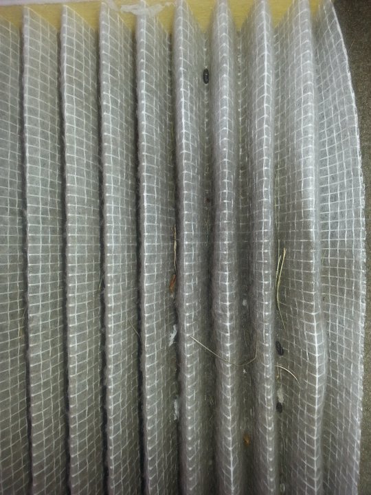

    Yes I do park outside, my pole barn is full of toys and also full of mice. It's wooded all around my house. But I have had multiple cars and trucks and non of them had holes to allow rodents to get inside. Under the hood yes but not inside. Got the traps set again last night and when the sun comes up gonna check them before I head off to the dealer.

    Went to the dealer today to complain about the mice getting in my car. They told me that there is no fix and did nothing. He claims they get in all the Toyota's on the lot. I said good my wife wanted a new Camry so now I won't buy one.
    So I drive home and decide to investigate how they are getting in. As the picture above shows the air filter, notice the three holes above the filter. The mice ate right through that, so I put 1/4" hardware cloth behind the plastic holes. I used wire and twisted it around the two vertical thin pieces of plastic. I then cleaned the filter (ordered a new one $27) and mounted a thin strip of hardware cloth to the back of the filter. I used a hot glue gun to attach cloth. Cleaned every thing up and hope it stops them.,
    The dealer would not even record my complaint, so Toyota doesn't even know how many people have this problem. Oh what a feeling.

    trust me, toyota knows. at least he admitted it, most say they never heard that before. if you're serious, read up on some of the mouse threads here, you may want to do more blocking before they start eating your wiring.
