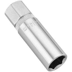

  13. StarCaller
    StarCaller Senior Member
    Feb 15, 2014
    1,284
    733
    Cedar Crest, NM, USA
    no rubber insert needed/
    it has a magnet inside - works perfect /
    click the image & it'll bring you to the website/
    Rebound likes this.
