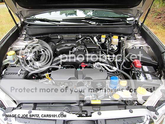

    In contrast, my wife's Outback is about the easiest car I've ever done an OC on. Being AWD with 18 inch wheels, ramps aren't required to reach the drain plug and it has an ample size access hole so cover removal isn't necessary. The filter is even easier being located on top of the engine.

    That's good, but I like best vehicles which don't require crawling underneath the vehicle at all---much less jacking it up and coping with a cumbersome under-cover. For example, our 1966 inline-6 F-100, or my late lamented '81 Mazda. The former has so much empty space in the engine compartment between engine and inner fender that you can hop inside and stand beside the engine with both feet on the ground. My Subaru required crawling under the engine, although it was reasonably easy otherwise.
