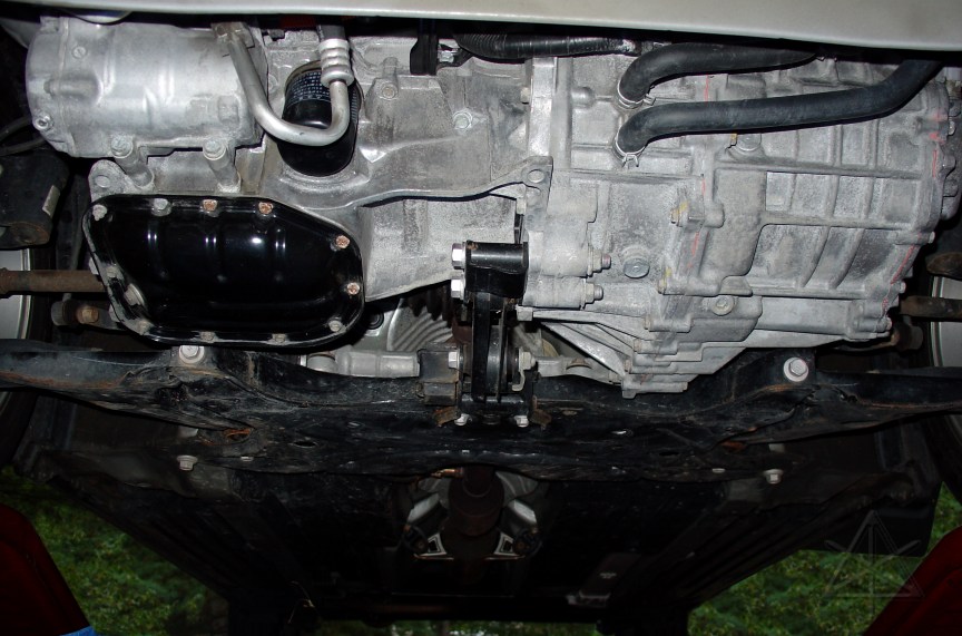

    Hobbit has a photo from "the naked Prius" presentation that shows the bottom of the ICE and transaxle from a 2004 Prius:
    The inverter coolant drain plug is just to the right of the lower support bracket in the center. To the right and rear is the transaxle oil drain and above it, just behind the lower coolant hose, is the fill plug.

    Does this look right? I did a quick powerpoint slide/jpeg to help me see the correct plugs...
    Cheers,
    Curt.

    The illustration is very helpful - I'm at 61k miles on my '04 and have been contemplating this thread as I put 70 miles a day on my car. I'll have to reference the Repair Manual though to see how difficult it is to reach that fill plug - do you think a pump is required?

    <div class='quotetop'>QUOTE(finman @ Jul 14 2006, 10:39 AM) [snapback]286216[/snapback]</div>
    That looks right. I have an NHW11 which means I have a drain pan. However, I think Frank can confirm the plugs.

    <div class='quotetop'>QUOTE(bwilson4web @ Jul 14 2006, 04:06 PM) [snapback]286457[/snapback]</div>
    those are the correct plugs and what they are for.
