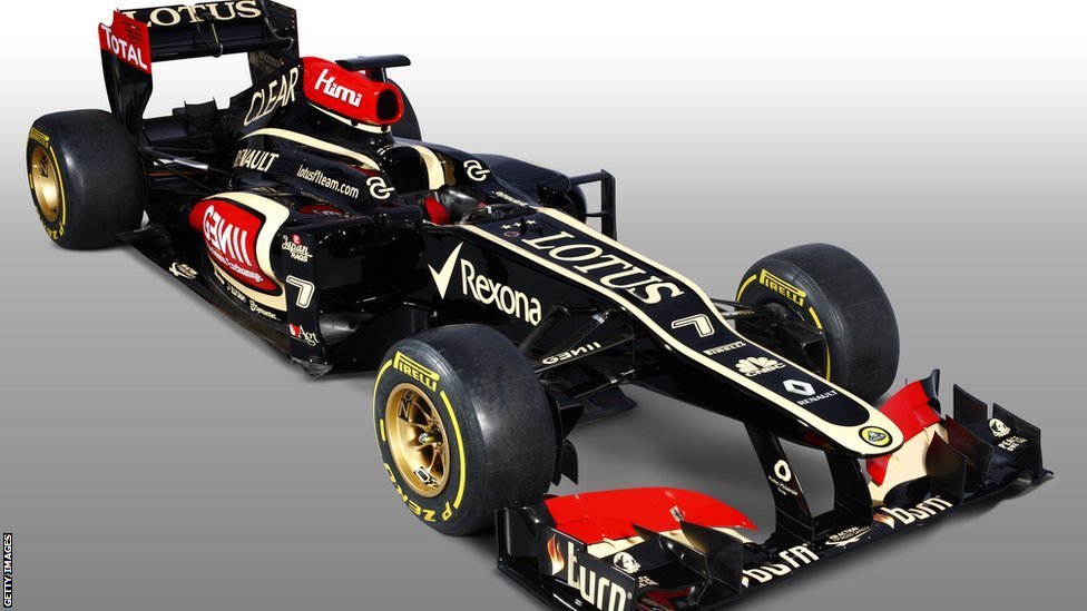

    Which is odd as race cars run wheels as small as 13 inches, must be for the ride as everyone know race cars don't need handling.[/sarcasm]
    Formula One
    Indy car

    The mandated 13" rims and high aspect ratio spec Pirelli tires are anachronistic, with the sidewalls providing a significant portion of the "suspension travel" in today's F1 design.
    Next weekend, at FOM request, Pirelli is set to test 18" rims and low profile tires on the Lotus.
