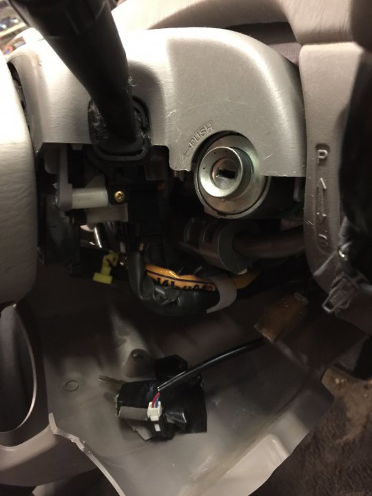

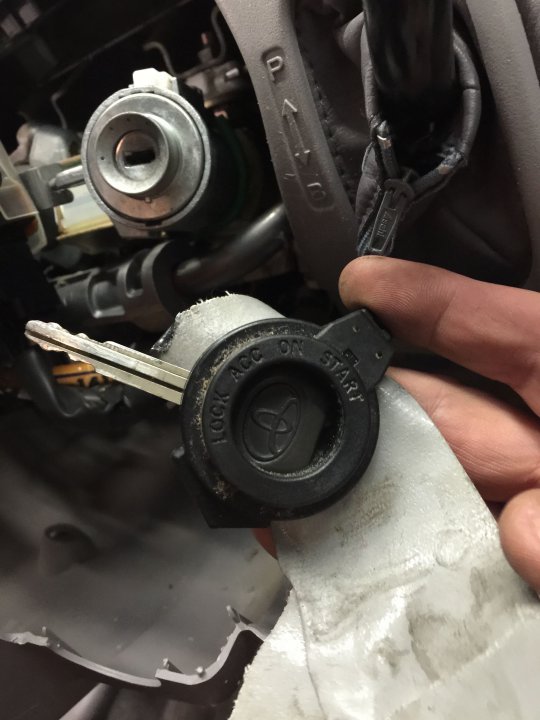

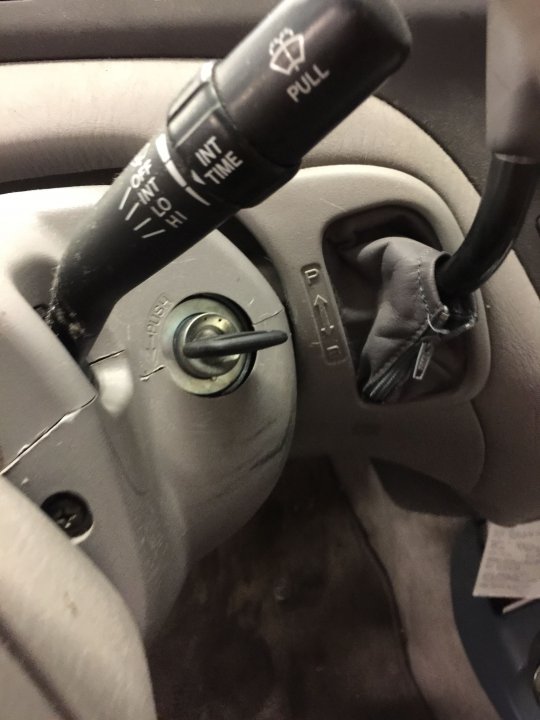

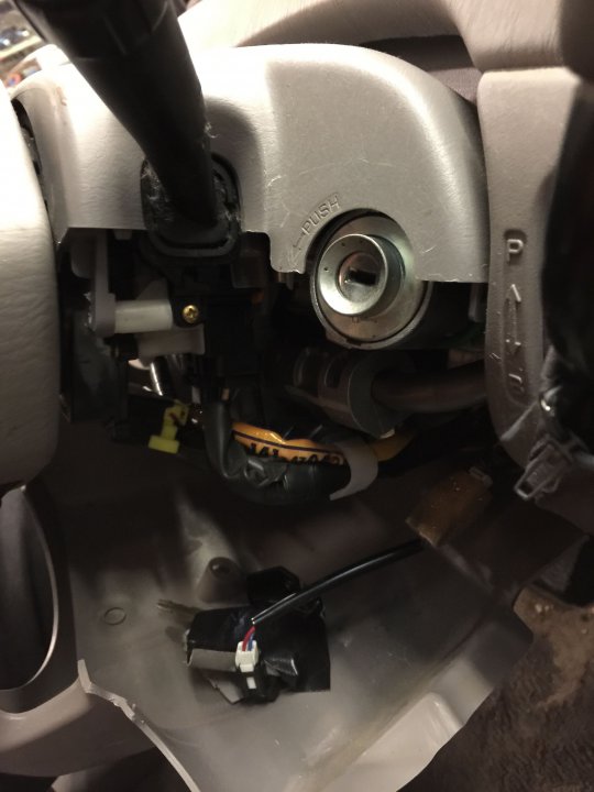

    If you only have one key (master or valet) for your Gen1 Prius and lose is, you are hosed. It will cost many hundreds of dollars to make your car drive again.
    If you only have a valet key, there is no cheap/easy way to make more, you either have to "clone" the valet key at an auto locksmith, or replace/reflash the immobilzer ECU which is buried inside the dash and a PITA to get to in order to add new master keys.
    Solution?
    Copy the valet key onto dumb blanks (i.e. no chip) for $2 each at any hardware store. Make a couple of spares. Remove steering column covers, remove black key detection ring around lock cylinder (but re-hook up the wiring harness), duct tape your valet key to black ring, duct tape to inside of lower steering column cover. Put it all back together.
    Now the $2 key starts car and becomes your daily key. It can be easily duplicated from your spare if lost. Cons? any key that will turn in the ignition will start the car and lock cylinder looks a little funky without black ring...but how many thieves will go after a Gen1 Prius?
    The bottom cover has 3 philips screws, one at very bottom, two behind steering wheel (turn wheel sideways). The top cover has one screw going up near the cylinder you access after you remove the bottom cover. One more screw holds the black key detection ring around the lock cylinder.

    If it was my car I would replace the immobilizer ECU and make a new master key, but this was a customers car for a family on a limited budget. This was the best solution for them since multiple people share the car. I used Gorilla tape to hold the key to the ring, and the ring/key combo sits in the bottom steering column cover in a sort of pocket area by itself, it should hold up in the dry Colorado climate.

    Regarding gen1, there is no battery in the key. It is only an RFID proximity based system and the key needs to be fairly close to the detection ring. Think of the detection ring as the antenna for the system, the ECU is just the electronics. Taping a key to the transponder/immoibilzer ECU won't help, it needs to be near the detection ring. If you plan on taping/glueing a key somewhere experiment first, I found it had to be very close to the ring, that is why I removed the ring.
