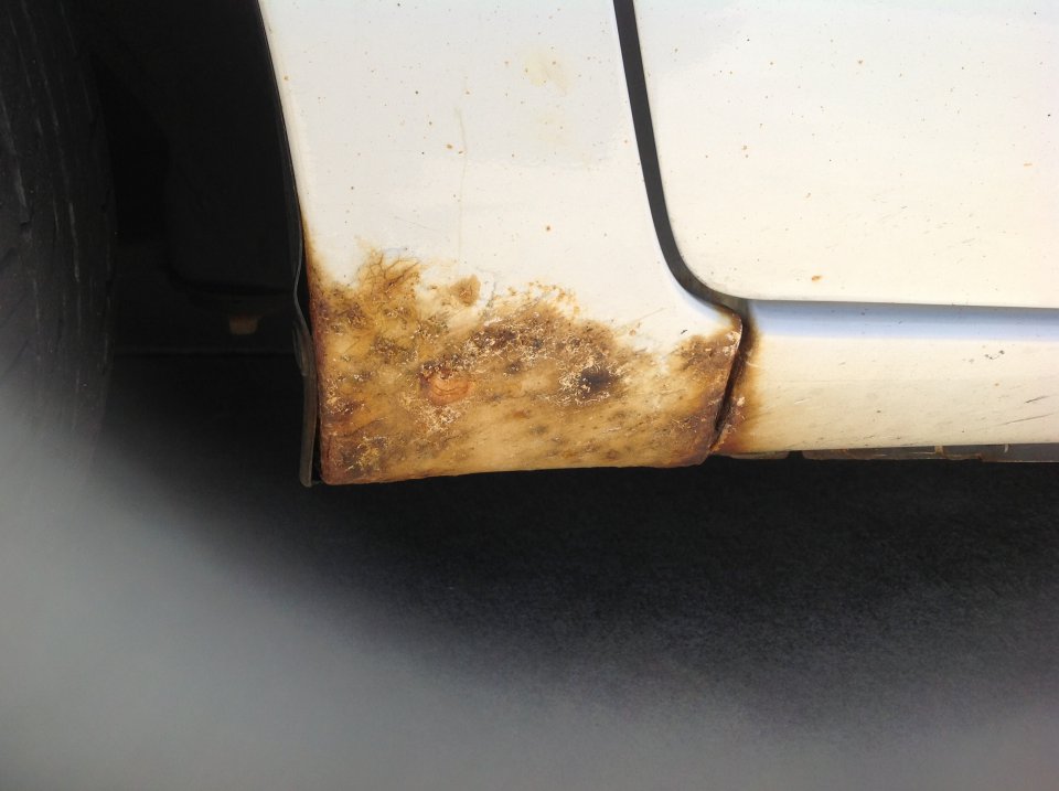

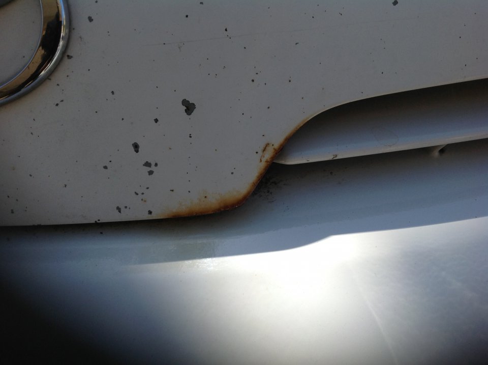

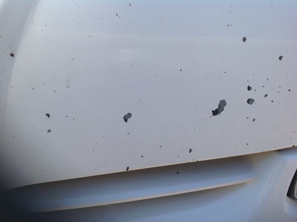

    I have some rust on my prius. There are some areas of pretty extensive rust like behind the wheel (image 1). There other areas there are small spots of quite superficial rust (image 2). Finally, the are some areas where there is just no paint (image 4). I am not hoping to get it done professionally as it might be expensive. Looking for a cheap solution even if it is not cosmetically pleasing. Someone suggested using sandpaper and then finding any ordinary paint.

    Where has the car been? That's nasty quarter panel rust.

    Usually, rust near the wheel well, as in the OP's photo #1, starts from the inner surface of the fender. So any cosmetic treatment will be short-lived.
