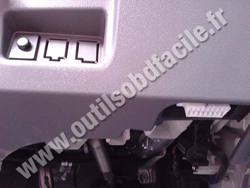

    In YOUR car the port itself is a white squarish plug located under/behind your dash about where your brake pedal is.
    Once you get the code(s) you may determine whether it's something simple like a loose gas cap, or something much more severe like a cylinder missfire.
