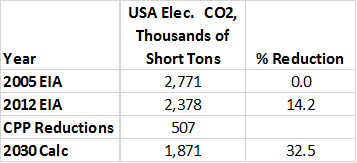

    Here is my corrected audit of the broad Clean Power Plan goals.
    Holy cow, it is really 32% reduction of 2005 CO2 levels - so that's one helluva task, approaching 45% per capita reduction:
    Since the EPA gives the states a mass-based (above calcs) or emissions-performance compliance options, it's possible the 32% might not be met exactly - but darn near, assuming states comply. If I use AustinGreen's alternate EIA CO2 data source, I actually get closer to 35% reduction.
    I am using the following source data:
    For USA 2005 and 2012 CO2:
    EIA - State Electricity Profiles
    For EPA 2012 to 2030 Planned Reductions:
    Clean Power Plan State-Specific Fact Sheets | Clean Power Plan Toolbox for States | US EPA
    2012 data must be hand entered for each state, the 2022 and 2030 goals can be copied from various sources. I also did the Navajo Lands 2012 as a side-calc from the raw EPA data spreadsheets.

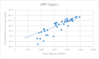

    Here is a plot showing state % CO2 reduction vs. carbon intensity of the state. So the higher coal states have the biggest reduction. If you're below the line, maybe 2012 was an atypical year (I'll try to capture that later). Had to delete a few wildly negative (small) states. But wow 30% reduction in 15 years considering population growth is no easy task, I am thinking. This is change from 2012, not 2005.
    #66 wjtracy, Aug 19, 2015

    I've been able to make almost complete sense of the EPA Clean Power Plan state targets.
    All states fall on a single operating line of CO2 reduction targets, as follows:
    When you look at the raw data without adjustment, it looks funny. For example, Virginia@1500 lbs.CO2/MWhr shows zero CO2 reduction. But that's because Virginia is apparently planning a 50-60% increase is MWhrs versus the population growth rate of about 15%. Assuming Virginia were to hold at 15% power growth, the CO2 reduction target is as hard, if not harder, than everyone else in the cohort (about 25%).
    Therefore the state CO2 targets reflect the state plans to grow or shrink electricity production. So an apparent "easy" CO2 reduction mass goal, could in reality be difficult. What that says is your state must first reduce CO2 mass to a much lower base number, which results in greatly reduced carbon intensity per MWhr. Then if you want to increase elec production, you can do so, but at the greatly reduced carbon intensity. The growth element gives the false impression of a "powder puff" CO2 target (in the case of Virginia).
    #69 wjtracy, Aug 20, 2015

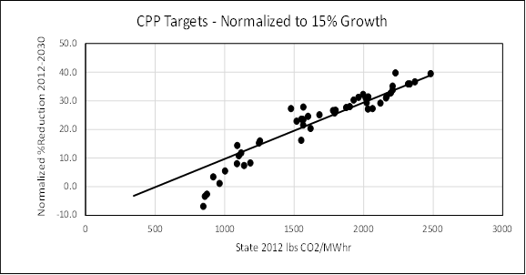

    Here's an even better correlation (Figure-P70):
    This says everyone has a big CO2 reduction job, some states have ultra hard job.
    If you make the same amount of elec in 2030 as 2012, this is how much %CO2 reduction you need.
    If you choose to make more elec in 2030, fine but it must be at this lower carbon intensity.
    The CO2 mass targets are hard to understand because it has to do with elec growths plans which vary from state-to-state. The average state is increasing elec about 18% by 2030 (in the subset of power plants the EPA is regulating). Some states are expanding 50-60%.
    #70 wjtracy, Aug 20, 2015

    Inherent in the state CO2 targets is EPA's elec growth assumption for your state based on 2012. it averages around 15% elec growth ( I still need to do a MWhr weighted avg) which is similar to the population growth predictions, You can get this value by dividing your state CO2 mass numbers by the CO2 rate (lbs CO2 per MHhr). Looks like this:
    AR 4.2% RI 10.8% CT 12.2% NV 12.2% NY 12.2% SC 12.2% AL 12.2% OK 12.2% IA 12.2% AZ 12.2% W V 12.2% MD 12.2% WI 12.2% NE 12.3% ME 12.3% NM 12.3% NH 12.3% GA 12.5% MI 12.5% WY 13.5% ND 13.6% TN 14.4% KS 14.8% OH 15.2% IN 15.4% KY 16.4% PA 18.3% TX 18.4% LA 18.8% CO 19.7% MT 19.9% FL 20.4% CA 22.1% MI 22.5% UT 22.6% IL 22.7% MO 23.4% ME 29.4% DE 34.1% MN 34.5% NC 37.2% NJ 46.7% VA 58.5% OR 103.9% SD 112.3% WA 132.5% ID 136.0%
    So if you compare TX mass CO2 targets vs. say VA or NC, you get the impression that VA and NC got "powder-puff" easy CO2 targets. But in reality every state falls on the same degree-of-difficulty line (see Post #70). The growth rate multiplies to state carbon intensity to give final CO2 mass targets.
    If every state were static since 2012, not building any plants, all of the state targets would fall on the same exact equation. But in reality some states are static while some states are already off building new plants (moving targets- shall we say). So EPA tried to make the state targets jibe with changes since since 2012. I have yet to determine if VA was treated fairly, or maybe we got harder targets, not getting full credit for NG plants already in progress (my hypothesis - we got nailed)
    Note: this only growth rate only applies to regulated portion. If you look at VA for example, a whole lot of power is imported, and a whole lot also comes from smaller facilities (eg; landfill gas ) so the growth rate I am talking about is just the subset that EPA is looking at (big utilities).
    #72 wjtracy, Aug 21, 2015
