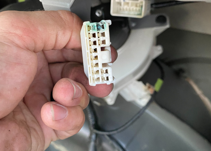

    P3000 is the only code, someone told me to drive it more to get more codes but I was thinking that may do more damage than good. I ordered Techstream and am hoping that will get more codes before I get a new battery.

    I don’t know what the lights all stand for but I did purchase a Techstream OBDii cable and l got the codes P3000, P0A80, P3024, C1259, C1310, and the classic solar sensor code.
  7. Maria Camille
    Maria Camille Junior Member
    Mar 2, 2023
    18
    Arkansas
    Thank you. My connector has a teeny bit of corrosion that I have sprayed electronic cleaner on. I also cleaned my hybrid battery fan while I was working on the connector. My next step is going to be cleaning that more with some de ox it and a nylon carburetor cleaning brush that I purchased from Amazon for $6. I don’t think that’s the problem, though because I got a bunch of other codes including P3000, P0A80, P3024, C1259, and C1310, when I utilized my new Techstream cable.

    I didn’t extensively clean the corrosion off of the wires and connectors because they were in rough almost fragile looking shape after 207k miles and lots of blue fuzz. I did what I could with vinegar and a toothbrush. There’s still blue corrosion on some of the wire connections. Is there any info out there on how to work up the harness if I need to?
