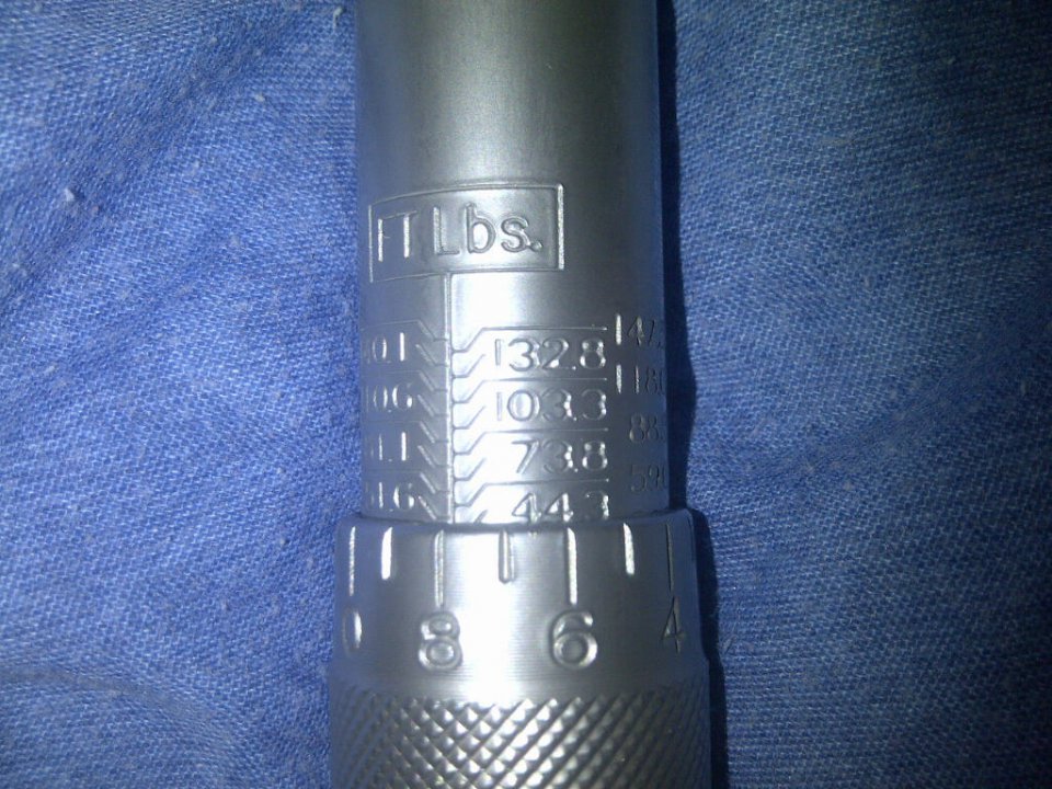

    my torque wrench arrived today and I don't have a clue as to how you set it to 76 Ft Lbs
    All of the numbers are uneven which I didn't expect!!
    How would I set round numbers on this wrench?
    On the other side, there is a NM scale aswell
