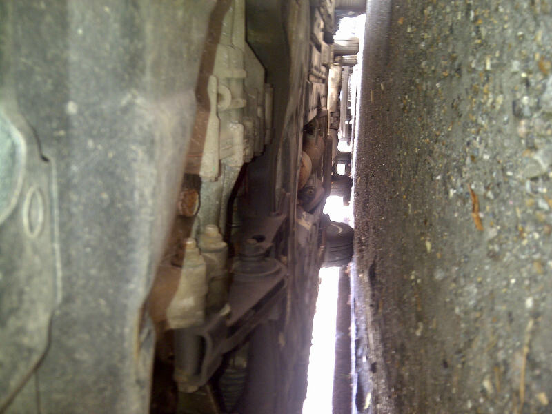

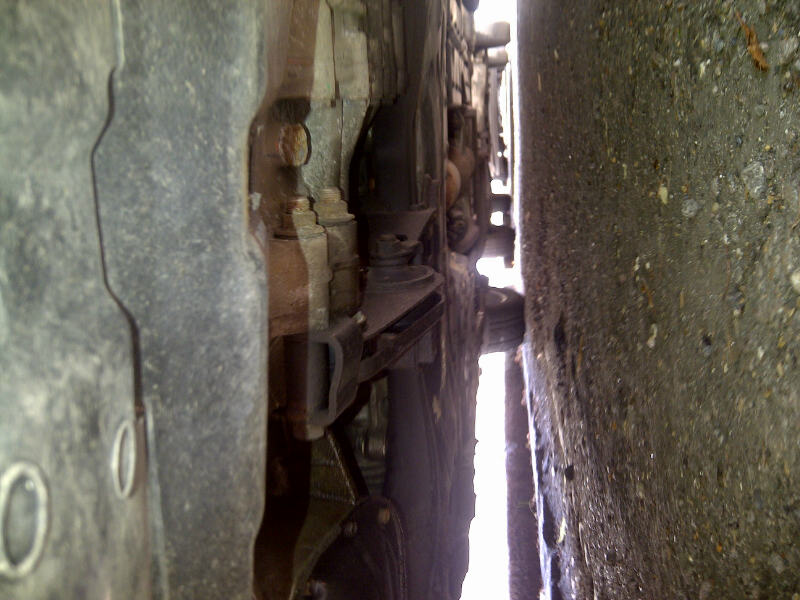

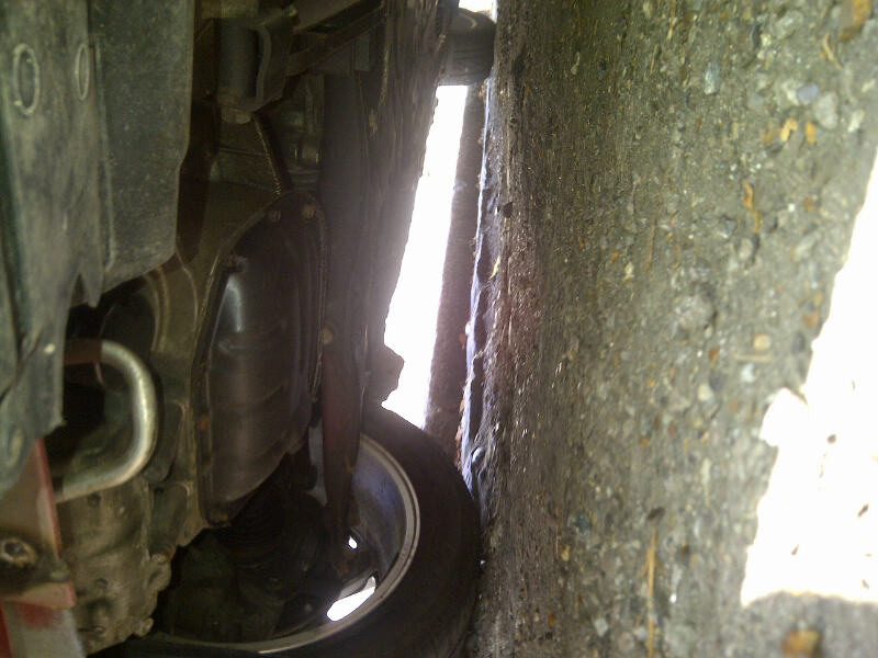

  9. Sam Dean
    Sam Dean Member
    Jun 12, 2013
    255
    i can't find anywhere with a completely even ground so i've been trying to jack the car up on the road outside my house, where my car is parked. I can't seem to figure out where the front jack points are. I'm attaching a few photos i took of the underside of the car, so if anybody can point out where it is - i'd be grateful

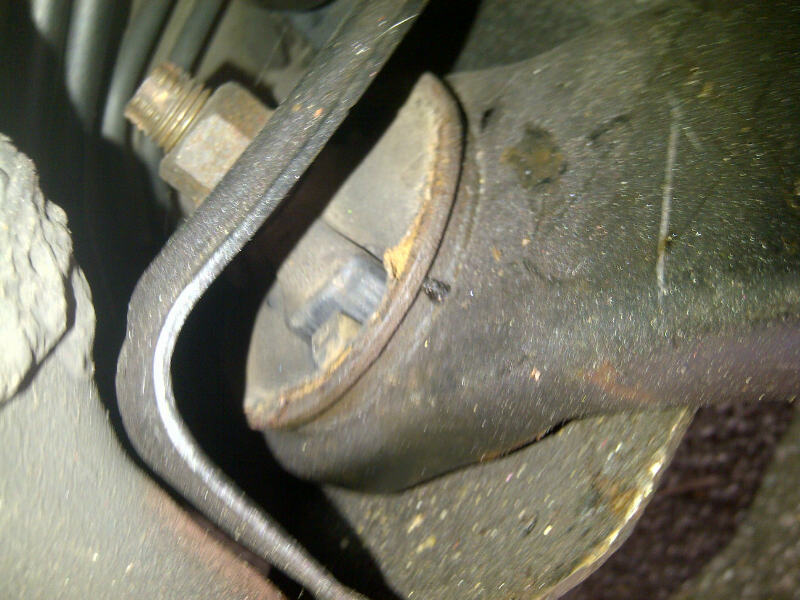

    ...but then the next step posed abit of a problem....removing the wishbone!!!
    Which nuts do i need to remove? I started by trying to move the 3 which connect the wish bone to the ball-joint, but these just were not moving at all!
    i'm attaching a photo that i took of the damaged bushing. It appears to have a nut on the top of it, aswell as beneath it - so does this mean that i would need to hold the nut at the bottom whilst spinning the top one anti-clockwise?

    it would still be nice to know where i can jack the front of the car up via front jack points
    i couldn't see the points from under the front of the car (photos posted in earlier post)
  13. Britprius
    Britprius Senior Member
    Jun 14, 2010
    5,194
    1,922
    Herefordshire England
    Sam I will post some pictures of where to jack the car tomorrow.
    The bolt will probably need to be held while you undo the nut. Some of these bolts are going to be tough to move to start with, and I suggest you buy some WD40 and spray anything you think you may have to undo.
    John (Britprius)
  14. Sam Dean
    Sam Dean Member
    Jun 12, 2013
    255
    thanks John
    From what I could see - there was a bolt on the big bushing, 1 on the small bushing and 3 around the ball joint....
    i have to undo all of these, with the small nut on the top going anti-clockwise, right?
    i'll stick abit of lubricant oil into these joints when i start doing the job. I think I'll order the bushing before re-attempting - I'll just assume the wishbone is healthy (so skipping the wishbone checking stage).

  16. Britprius
    Jun 14, 2010
    5,194
    1,922
    Just remember (except in very rare circumstances) looking at the end of a nut to undo is always anticlock. Make sure you use the correct size socket or spanner, and always use the ring end of a spanner (not the open end) whenever you can.
    I am going to say you will end up with bruised knuckles till you get the hang of things "comes with the territory". The number of bolts sounds about right some may not slide out as easy as you would like once undone. This bit is called sods law, and some find a swear word or two comes in handy, and seems to help.
    John (Britprius)
