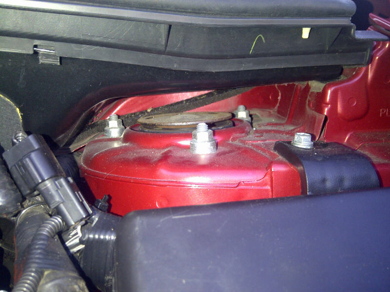

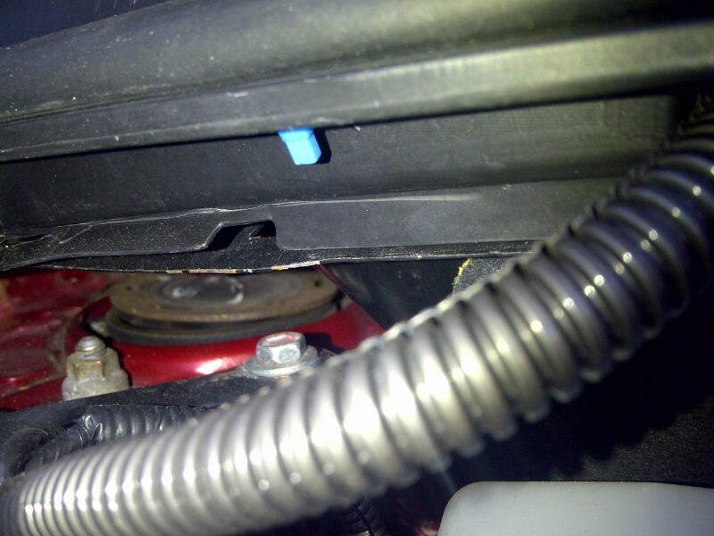

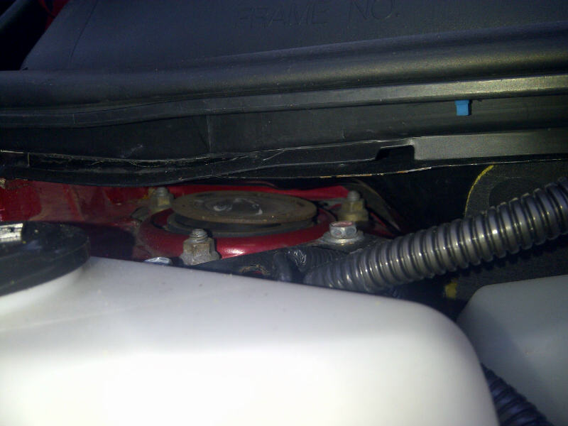

    so i changed both bushes on the right hand side front wishbone and the clicking was still there
    I had a local mechanic look into the sound alittle deeper and he found that the top of the strut mount on the right hand side was not even - in comparison to the left hand side
    i think they re-used the whole strut and shock absorber maybe from the collision (?)
    here are 2 pictures of the faulty looking strut mount and 1 picture of the healthier one
    what could this be? is it just a case of replacing the strut mount - or could it be the whole shock absorber aswell (maybe being bent?)
    how can i repair this? I have seen quite a few instructions online - but I don't know how to diagnose this and pinpoint exactly what it is that needs replacing
    thoughts welcome
