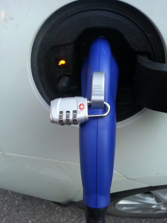

    Very bad idea. Crimping a power cable can lead to a bad connection or even a fire. There is a small hole in the release button of the charging connector, through which you can put a luggage lock.

    Adding a luggage lock and locking the plug into the PIP is a must better idea, than closing the car door on the cable.
    From Home Depot:
