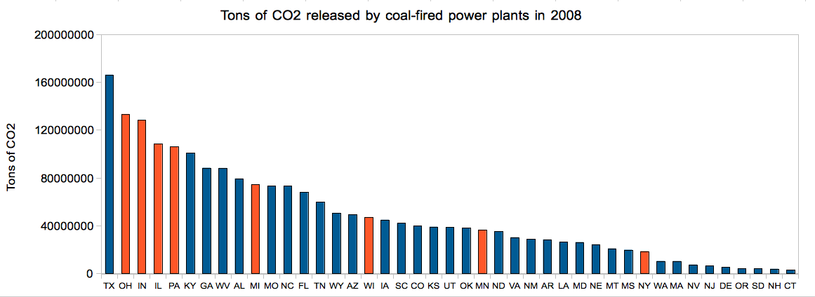

    Ok ... I'll use the big red numbers as a (theoretical or actual) given. Now if we go back to the "50% of electricity comes from Coal" issue, consider how some states use more coal, and some use less, and so you get 50% average. From maps I've looked at, many of the heavily populated (people AND cars) states in the US (like Calif) often use less coal. Perhaps the good thing is that in the areas where there will naturally BE more EV's & PHEV's getting used (due to more cars being there) ... there will also be less coal used in those areas. So, just because electricity comes 50% from dirty coal ... doesn't necessarily mean 50% of the EV's & PHEV's will be getting their electricity for a 50% ratio state.
    It looks from these charts like Texas & Ohio are worse, as far as coal/population ratios go ... New York & CA seem to belch the least coal. (If you don't count how much coal power CA gets from AZ)

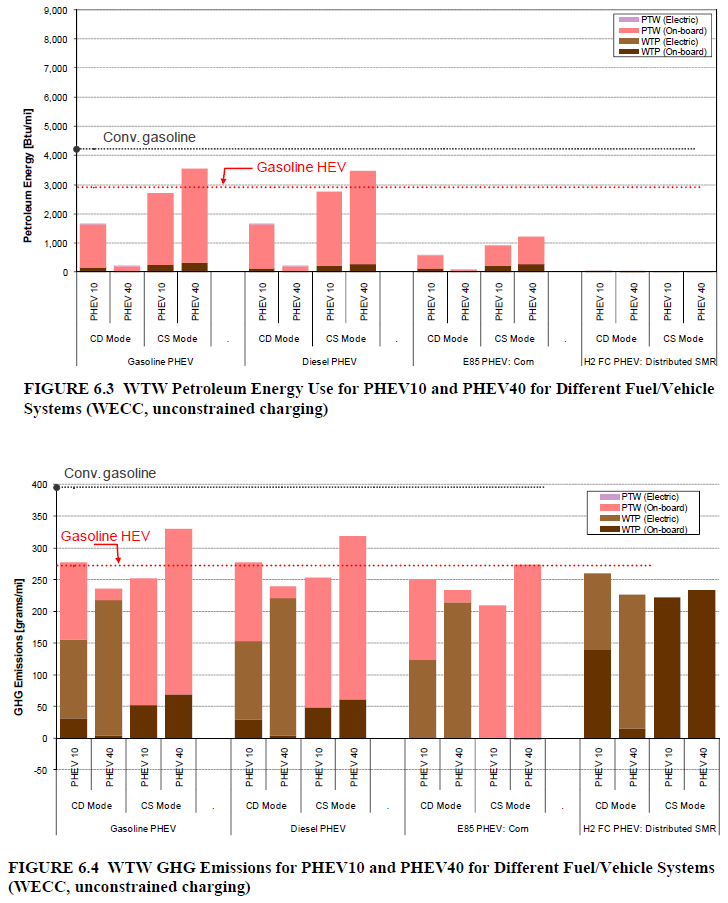

    Hill, I think you are discussing the weighted fraction of coal use in an EV. A number of good research articles have been published on this topic, so far as I remember all the recent publications are based on DOE's GREET model. May I suggest starting with
    Elgowainy, A et al published June 2010. "Well-to-Wheels Analysis of Energy Use and Greenhouse Gas Emissions of Plug-in Hybrid Electric Vehicles." If you are the type that likes to look a a picture for an executive snapshot of things, click on the thumbnails. Note two things: as the fraction of EV/petrol miles increases, so does GHG/mile; second, things get worse as 'smart charging' is utilized. 'Smart' is the power utility label for increased coal use.
    A longer list of GREET based studies from Argonne.

    The latest from Elgowainy, June 2010.
    I cannot remember if the presumed GM Volt efficiency was the early hype or the later reality.
    Volt Vs Prius:
    In NG dominant regions about the same GHG/mile, ~ 10% less if "smart" charging avoided.
    In Coal dominant regions Volt has 1.57 times the GHG/mile.
