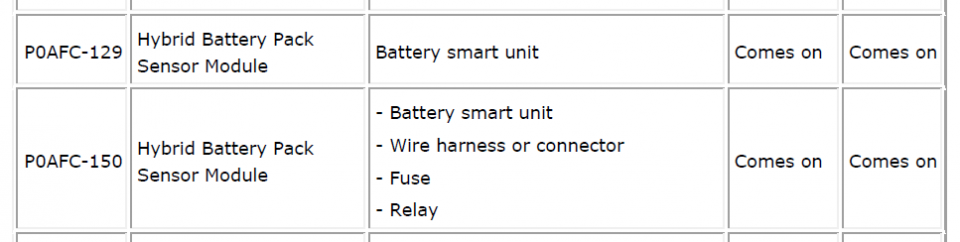

    Doesn't look like an inverter issue...

    Yes that's the Gen III 2010 codes pdf I found - I was writing from memory. Not an inverter issue.
    I'm surprised at the relative uniqueness of my fault code's (non)appearance here on PriusChat. Not a good way to be a pioneer...
