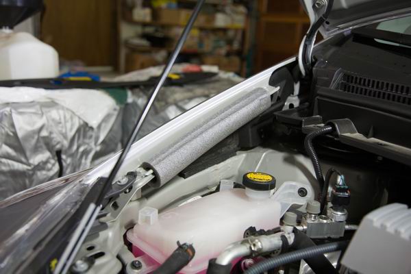

  16. Mendel Leisk
    61,327
    42,205
    I'm using grill block, 50% of lower opening when daily max stays below 18deg C, 100% once temps are around or below 0deg C.
    Also use our block heater, year 'round, aiming to have it plugged in for a couple of hours before first drive of the day.
    A good trick is to simply consolidate trips as much as possible, and reduce short distance impulse drives.
    And here's an engine bay block I leave in, year 'round:

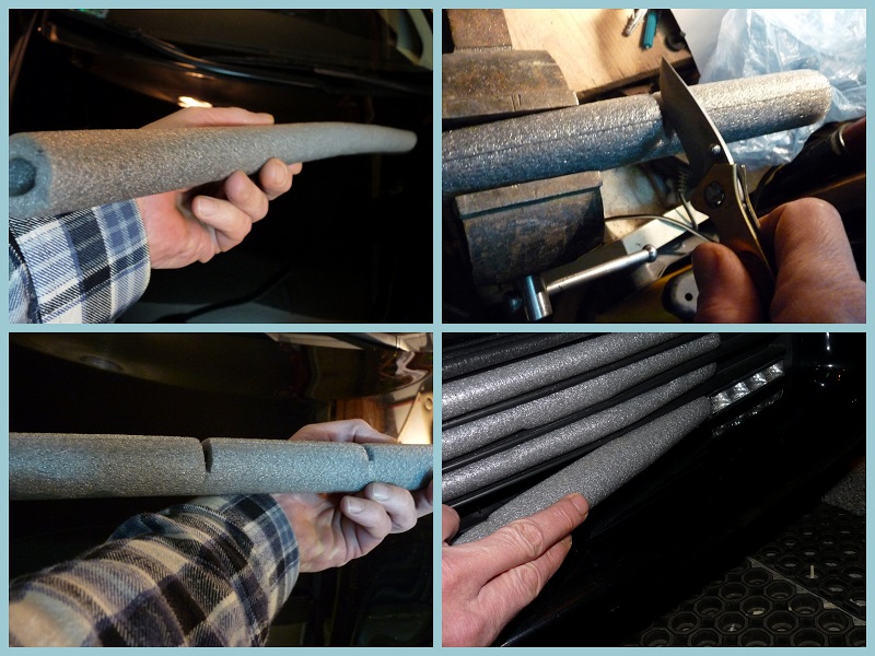

  18. Les_PL
    Les_PL Active Member
    Nov 11, 2012
    317
    249
    Gdynia, PL
    1. Buy 1" PVC foam insulation pipe;
    2. Cut appropriate lenghts for each grill opening;
    3. Cut slots for internal grill vertical ribs;
    4. Push inside;
  19. agreendc
    agreendc Junior Member
    Jun 30, 2013
    Amherst, New York
    Sweet, thanks a lot Les. Exactly what I was looking for. I thought it was gonna be that easy, just wanted to make sure.
