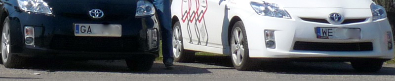

    I use the pipe insulation with OD of about 1.5". It pushes onto a slat (via its longitudinal slit). Two rows of tubes cover the whole lower grill. It's not really needed to cut transverse slits in it, at the vert slats. I secure it with a strip of Velcro near each end. Use one row from ten C down to zero. 2 rows (100%) below zero C.

    These are the technical details. I'm happy with 1" and no fastening. It lasts firmly, tested many times on touchless hi-pressure car wash :)
    BTW - there are differences in dimensions and design of lower grill even within the same model and year of European Prius. Mine (black) - originally from France has five lower openings, the friend's of mine (white -purchased in Poland) has only four :eek:
    And they are more narrow (I suppose) than US versions. Whatever - the common idea is always the same :D
