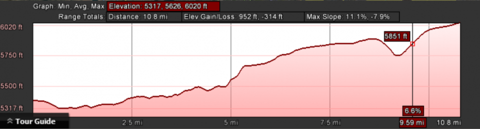

    This is my local test hill:
    To avoid the known engine ON cycle, I'll drive in manual mode until SOC is 80%. Then I'll set cruise control to complete the route to the top of the hill.
    UPDATE: cold soak 28F, at 9.8 mi indicated, 30% SOC, 65 mph climb using cruise control, the engine ON by itself with a significant growl and excursion into power band.

    Captured the event:
    • 34.51416 -86.59512
    • 57 mph
    • use "," to backup one frame and "." to advance one
    Doing a detailed examination shows a stretch of ~100 ft with a significantly higher grade. This triggers the subsequent engine ON operation.

  16. bwilson4web
    29,058
    16,520
    If I fat-fingered a decimal longitude or latitude, my apologies. The YouTube segment has the dash cam reported values. Trying to correlate to Goggle Earth is equally likely to have GPS ‘drift’ issues. That 28% grade is off the scale BUT it is a relative steeper part based on my butt-o-meter and the same spot as the previous day.
    I can use a 400 Hz, 3-axis accelerometer and get a more precise grade map but it would not change the engine ON event significantly. It is the local increase in grade that appears to trigger the engine ON. There may be a delay but it would be in the seconds range.
