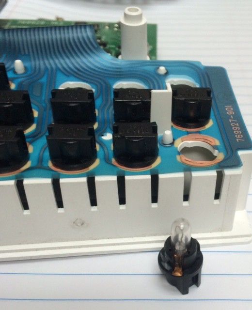

    Take the front bezel off and these two screws. The internal lamp carrier will flip out:
    Replace the burnt out light. I would recommend using the 'seat belt' light or the 'cold coolant' light. Seat belt because it really isn't needed by those with a clue. The 'cold coolant' light because it has no practical application. Then send me a private message with your mailing address.

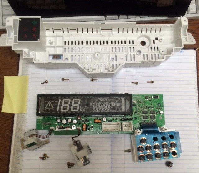

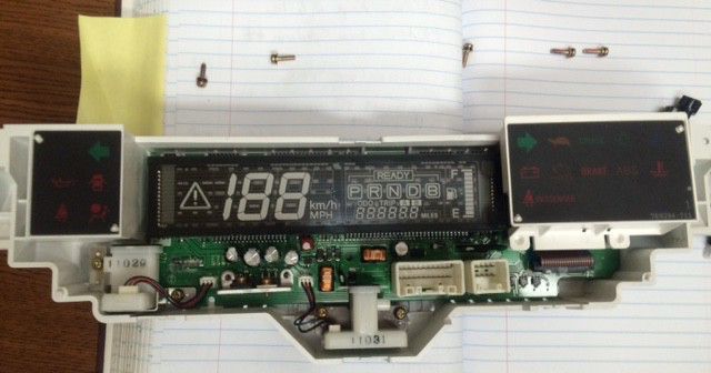

    The following instructions show how to access the logic board:

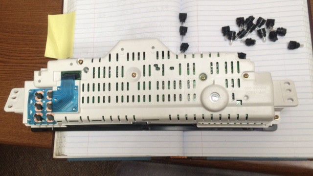

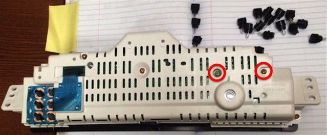

    I've removed the lights but the back shows five screws holding the back on. For our purpose, only the front, black fascia needs to be removed and the two screws on middle, right near the beeper.

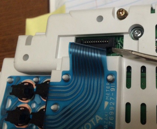

    There is a flat cable that feeds the lights on one side that has to be disconnected IF the logic board is being removed. It is not necessary if replacing a burnt bulb.
    At the lower center and left, are what appear to be tilt or possibly air bag deployment sensors. These have to be removed to take out the logic board. But this is not necessary if replacing a burned out light. My light, the cruise control, is in the box to the right. Removing the two screws on the back holding it on makes it accessible.
    Here is a light in its socket and twist base.
    Here the logic board has been removed, not necessary to replace a burnt out light. The lights and socket are on the right and it is held on by two screws.
