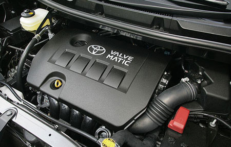

    Toyota is also going to manufacture with the Valvematic technology soon, which will not only control the valve timing but also the intake-valve opening. This is something luxury European sedans have had for a long time.

    The 3ZR engines are the 2.0 litre engines and yes, they'll be the first to include Valvematic technology.

    patsparks, all new TOYOTA engines built after 2012 or so will have the Valvematic technology. So, you won't be paying an extra premium for that standard technology.
