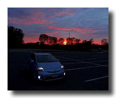

    Driving with lights on is pretty much all the time during the cold season, since it's quite often gray & gloomy during the day. The advanced package has great LED lights for that, nicely shown in this photo:
    Have an idea what their power consumption would be?
    slcMPG likes this.

    my HIDs are 35w each, but they are soooo much brighter. win win.
