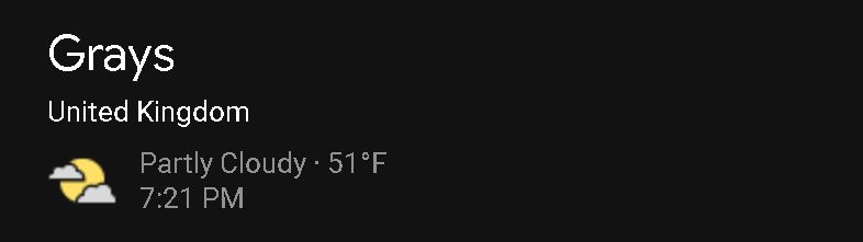

    Is it warm this time of year wherever Grays is, or cold?
    I ask, wondering if it would be practical to take both hoses off the heater core, and just couple the gozinta to the gozouta, drive around that way for a while, see if the rate of coolant loss changes?

    It's like 1 to 10 degrees Celsius, it's Ok.
