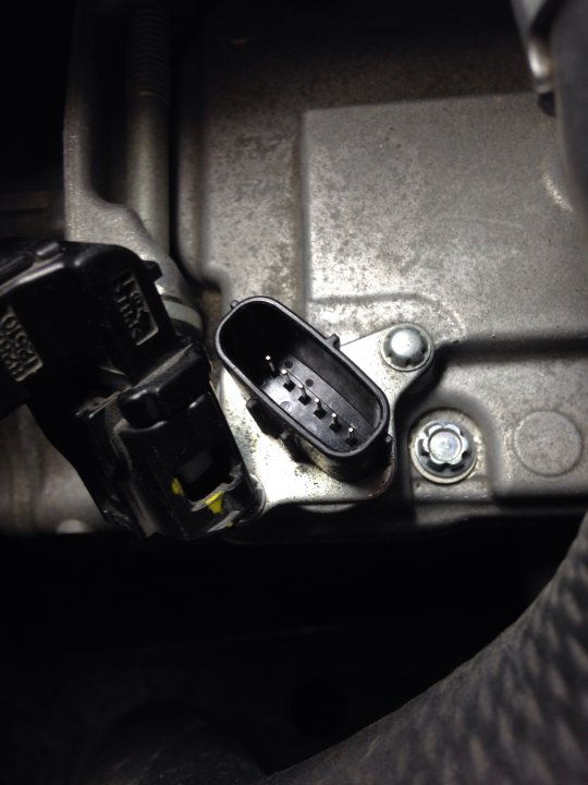

  3. Prius-Alfa
    Prius-Alfa Junior Member
    Dec 7, 2010
    22
    Seattle
    So I just got back from talking with a Toyota specialist who works independently of any dealers. He used to be a mechanic at a Toyota dealership. He's never heard of this kind of problem before. He doesn't buy the low mileage allowing build up of moisture and corrosion theory, but doesn't know what would have caused it. He's going to see if he can do anything to repair the connection on the compressor so that the whole unit doesn't have to be replaced. Maybe he can remove the receptacle from the compressor housing and make a repair. He was surprised by the dealer's recommendation to change out the wire harness. Probably them just covering their butts against any future problems associated with their work. The car goes in tomorrow. More to come.

    The picture of your connector with the green corrosion inside the connector is quite different from the corrosion on the outside of my connector. The outside of your connector looks clean. It looks like your connector may have failed for some reason internal to the connector, like maybe a loose connection that created high resistance. That would be a good reason to replace the wire harness plug along with the connector base. Good luck and keep us posted.

    Can you get a picture of the wire end connector? If you notice on the other picture of that connector there is an orange material visible inside it. That is the sealing material kinda like an o-ring. Is yours intact? When locked down that should be a waterproof connector as seen in the other pictures where the connector was pretty spotless inside. Yours may have been taken loose for some reason and not locked back down resealing it. The part looks like it is screwed on the compressor. One would thing it is replaceable then.

    I did notice that orange ring in the connector on my car. I didn't examine it closely but it looked fine. You may be right that for some reason the plug wasn't seated all the way down until it was locked and the seal wasn't as tight as it needed to be. If that's the case, it almost certainly had to have had to come from the factory that way because the AC system has never been worked on before. Based on Mendel's experience described in posts above about getting that same plug to come off on his car, these things aren't likely to just come off on their own. I'll have the mechanic take a good look at the o-ring tomorrow when the car is in the shop.

    Well, once the mechanics got a look at the inside of the connector on top of the compressor, it was on to a new compressor. They can't get inside the compressor to try to rewire the connector from within which is what it would take. Seems like a stupid design to me when a failure in a minor part like a connector can bring down a whole unit like an AC compressor. They can, however, splice a new pigtail onto the harness so at least a new harness at $722 isn't needed. Total bill: $2300.
    You guys may want to take a look at that connector on your cars and confirm that it is firmly seated and locked in place as a precaution against an expensive repair. It's easy enough to do. Remove three bolts holding the air intake box located on the front of the engine in the left front corner of the engine compartment as you stand facing the front of the car. The compressor is just below that with the connector right on top.

    That's frustrating. I wonder still about it being non-repairable: the compressor side of the connection is on a plate with fasteners, albeit unusually shaped fasteners.

    I don't know for certain, but I bet those fasteners are not intended to be taken apart. I think an effort to try to do something like drill those out and then figure out how to rewire and then close it back up would put the job into the realm of custom work with the costs and potential pitfalls that go with that. For someone who has a shop and the skills to DIY it, it might be worth a shot. If you trashed the compressor you would just be out your own time without having paid shop rates to get to that point.

    Can you get another compressor out of a salvage yard? Should be a lot less $$$. The heads look like screws to me. Special socket type that should be available. 10 to 1 there is a connector on the other side too and this part is just a sealed interface to the outside world. A socket like this one removes those types of bolts.

    Thanks for the info on the sockets. There are two fasteners visible in the photo at the top of this page. The upper one of those fasteners is one of two on the plate that the connector is mounted on. The second one is behind the plug on the left in the photo. I think you would have a very hard time getting any grip on that one because it is dome shaped. It doesn't have good contact surfaces for the inside of a socket. I suspect its some kind of cap that's crimped onto whatever is under it, maybe a rivet. That's why I was thinking it would have to be drilled out.

    The big question in my mind: even if you manage to remove those fasteners, how to replicate the damaged broken pins. Maybe you can get pins from an electronics supplier, do some soldering. Short of that: as long as there's no availability for the compressor side of the connection, you're still SOL. Which goes back to Toyota, poor design.

    To argue with the above: to salvage the current compressor, you don't HAVE to repair the pin connection. You only need to repair the breaks in that circuit. If the wiring behind the connector can be accessed, extensions could be soldered on, and a new connector (or individual connectors for each line) could be put in, a bit away from the compressor. The entry of wires at the compressor would also need to be sealed.
    This assumes the extent of the problem IS the connector.
    Thinking more about the reason for the corroded connection pins: could (for example) someone have tried filling the windshield washer fluid reservoir without a funnel? Maybe sent fluid running down that conduit?
