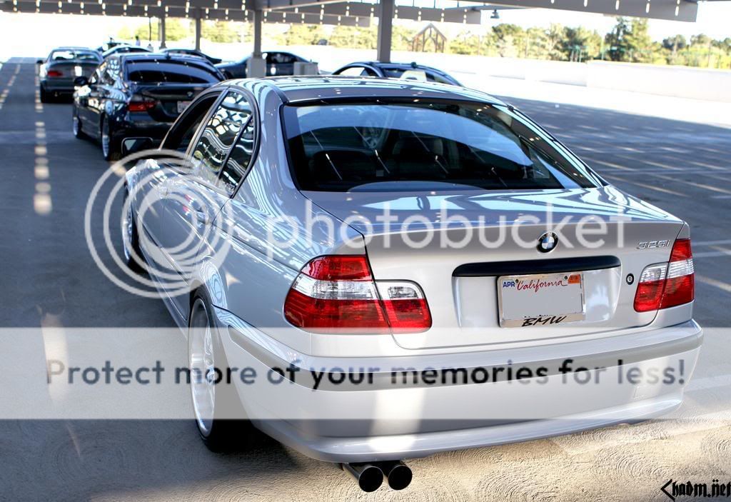

    EDIT: Hey Xenon, what do you think about instead of doing Red/Smoke/Red tail light pattern, I did Red/Clear/Red? Like this style BMW:
    I looked at the pictures of your car for like 15 minutes and after tilting my head up and down I think I realized the part I don't like is your Smoked middle section. I think it would look better if I left it clear. My question then becomes, does Metro Decals sell a completely clear film for the taillights (that is the same material as the red out kit)? Do I even NEED a film since I want it the same as the stock color. My main concern doing no middle film is that the 2 outer red films will be raised and may look weird since the whole unit won't be flush.

    Would anybody be interested in trying out the Aerotect colored vinyl? From other car forums I've heard it's more glossy, thinner and clearer than most brands. I'd only be comfortable going for the true, clear red like in the picture of the BMW I posted before. I'm aware that example is actually glass and not film but that's more along my lines. I really don't like the translucency and pinkish hue or dark smoked red of most of the more common brands like metrodecals and rvinyl. It covers up the detail of the light fixture and you can tell they are films. I was wondering if the Aerotect product is actually any different. Thanks
