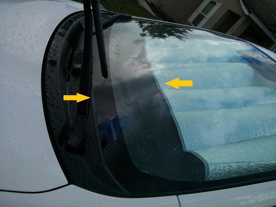

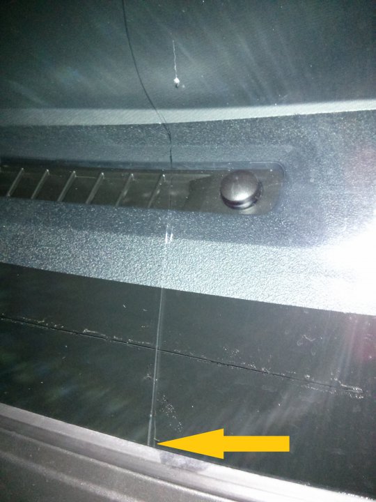

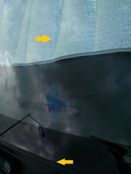

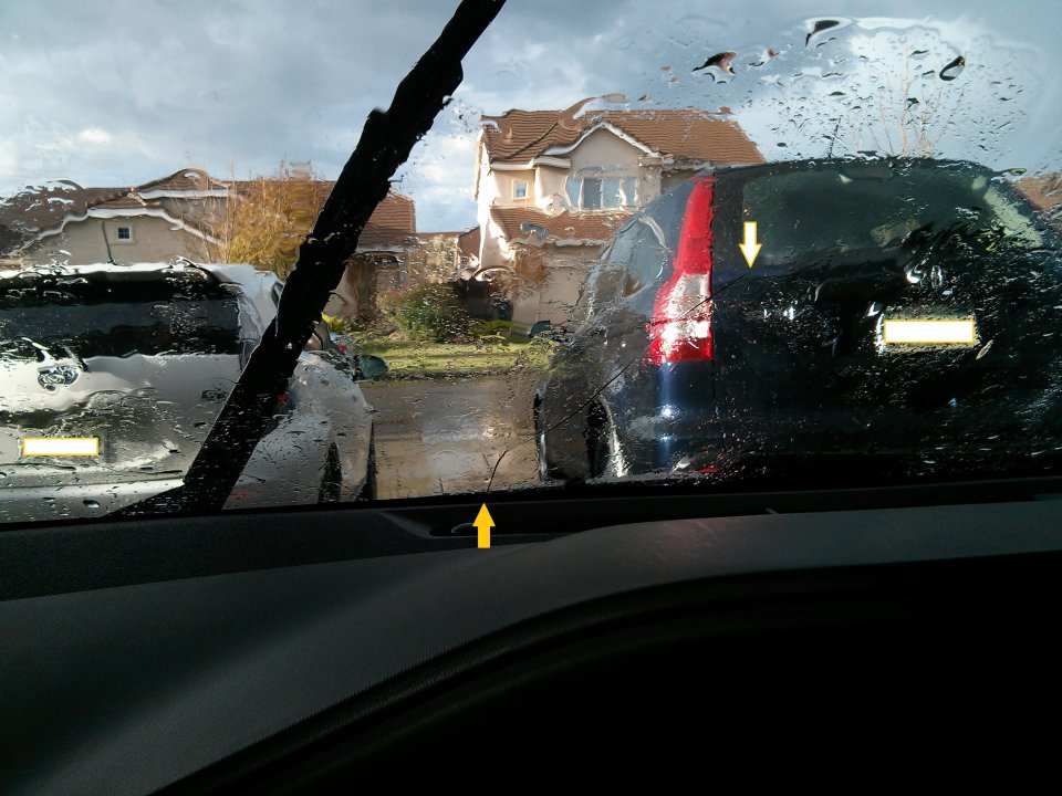

    So I just noticed that my C has a huge crack starting from the bottom of the windshield 9inches or so up...
    There's no sign of a rock chip, and it seems to have cracked from the very bottom/edge of the windshield up. It just suddenly appeared...any idea??? on if it's just randomly cracking or whatever? and if I can get Toyota to fix it, if it's a defect?

    thank you...yeah I've been googling a bit, and it seems some people with similarly cracked windshields were able to get toyota to fix it free of charge for them due to defect...it's only 6months old, I'm take it to them and see what they say
    the crack definitely started from the edge as in the picture and goes up

    Actually, it could be a manufacturing defect. Though rock chips are far and away the majority of cracks in windshields it has happened that a support for the windshield concentrated pressure on the glass at apoint and because glass isn't very prone to bending the windshield cracks under varying temperatures, bumps, etc.
    Take it to an independent body shop with experience repairing toyota windshields and see if the crack iniated at a sress point. Or a WSWreplacement shop who can remove the WSW and see if the crack becan at a specific support point. Nots not unbelieveable that the metal frame just happened to not quite line up smoothly with the WSW. Who knows maybe the WSW usn't that smoth either, or a bit of trash got inbetween the WSW and frame.

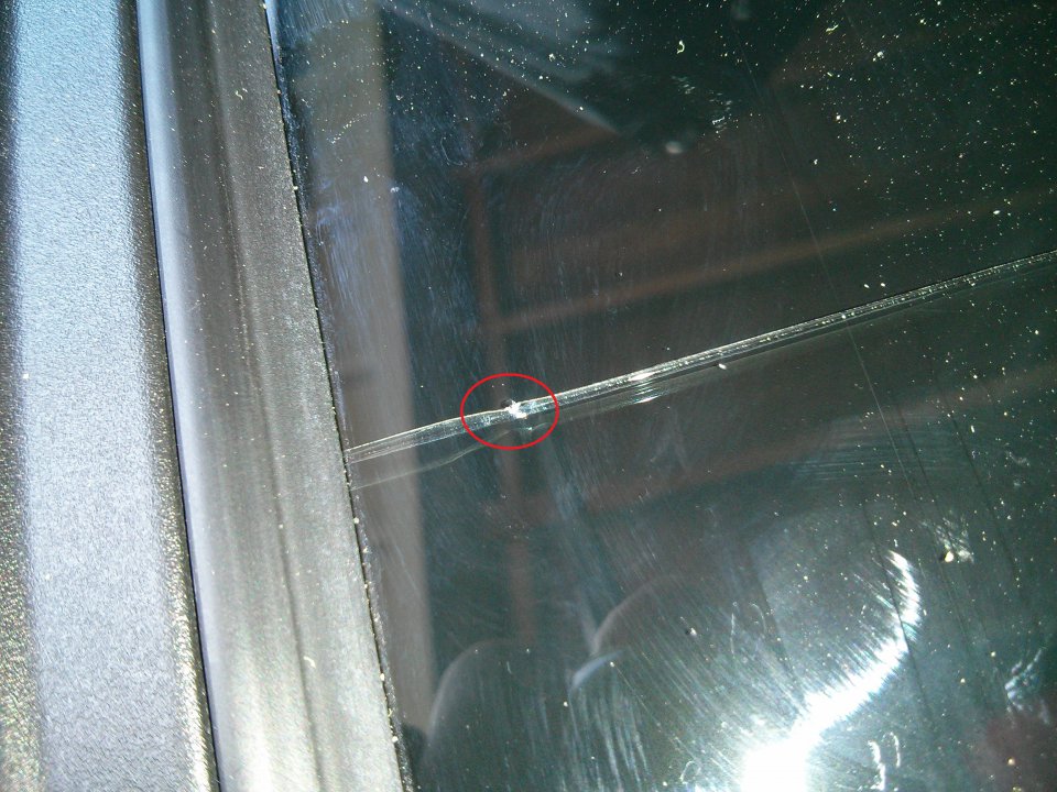

    well, I tried...after going over the crack back and forth, the service manager found a super tiny chip along the crack right behind the wiper (they said only way it would've hit was during the rain when wiper was being used), so I guess no warranty; they did also say that if I wanted I could have them disassemble the plastic/molding and check if crack is stemming from a installation point or whatever (but I guess that would cost some money for them to tell me again no warranty). I was looking at it and wondering if anyone got the instructions to take apart the windshield bottom molding/plaster covers. Thank you
