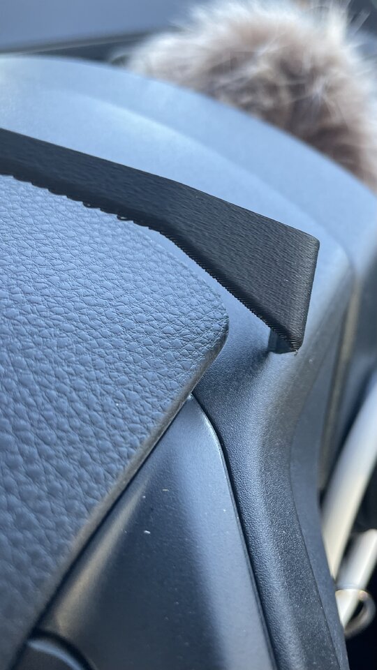

    Thank you. There are tons of filament colors but they are all matte, not shinny like exterior of cars. You would need to paint it with the same paint with your car. I used black abs filament, and I also used fuzzy skin feature to match the center console skin texture. I will take closer photos.

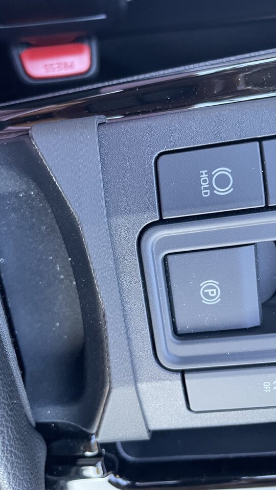

    Test trial bambu matte charcoal color. Pretty good match and texture with fuzzy is pretty close.

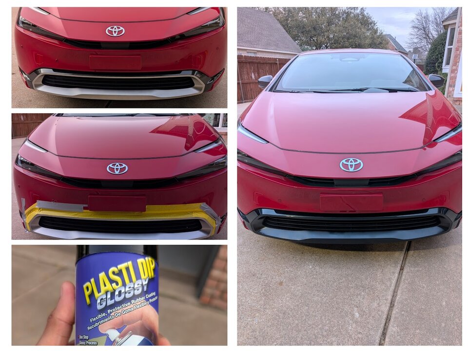

    2. Black overlays to remove the chrome "fish mouth" - I had to plastidip but a more permanent solution would be welcome.

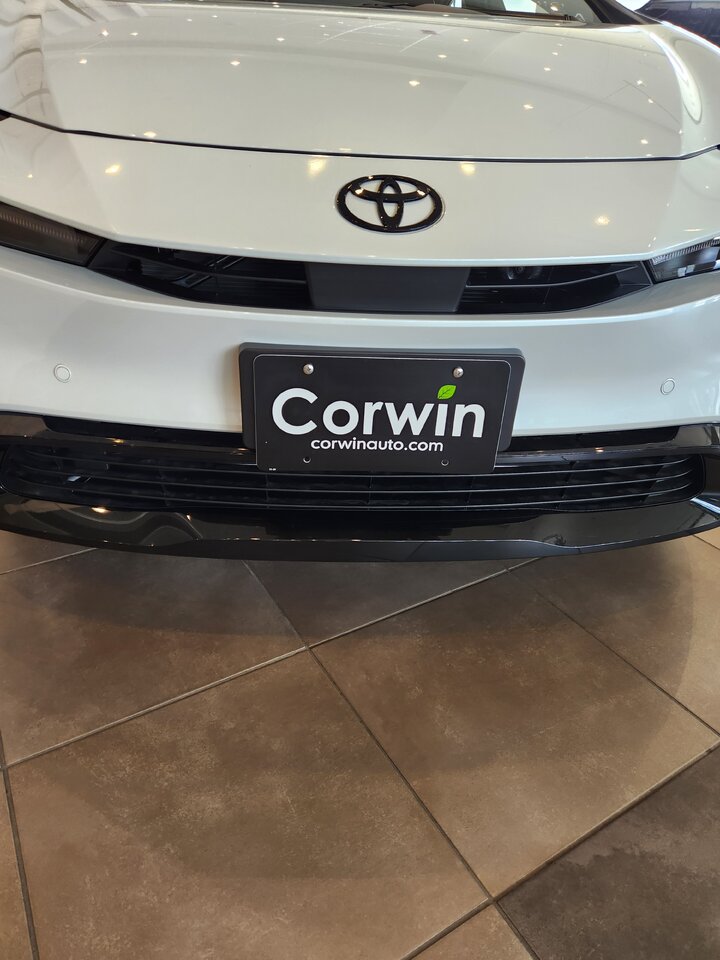

    It's probably also on national backorder for now, but you might consider the grille from the Nightshade Edition as a permanent solution. (Grille Sub-Assy, Radiator, Lwr) I'm pretty sure the grilles are compatible between the HEV and the PHEV, and your XSE is the same trim level as the Nightshade, so no problems there with the accent lights.
    I don't have the part number right now, but a Toyota dealer could probably help you with that. It will begin with 53102. Price should probably be around $150 during the 4th of July sale.
    A (bad)pic of the Nightshade grille:

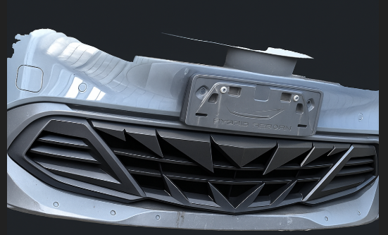

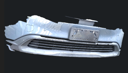

    I 3d scanned that fish mouth, and I asked chat gpt to design something.
    it gave me this:
    it looks good actually but I dont think I can't just put it there. :D
