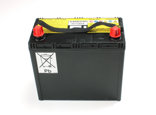

  8. pjksr02
    pjksr02 Active Member
    Nov 2, 2009
    534
    227
    Connecticut
    Time for a road trip? Lynch Toyota in Manchester, CT:
    Battery - Toyota (00544-21171-325)
    • [​IMG]
      • List Price:$220.76
      • You Save:$38.94 (17.60% off)
      • Sale Price:$181.82
      • Core Charge:$20.00 Core Charge Applies
      This part fits your 2013 Toyota Prius VChange vehicle
      UNABLE TO SHIP
      Product contains hazardous materials that we can't ship.
    Grit likes this.
