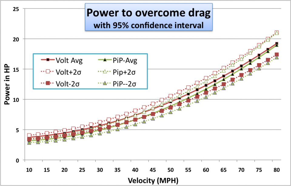

    Interesting post Bob, thanks! When you said it had signficantly lower drag I expected a bigger gap. I was already curious how these were defined and estimated so I went and did some reading.. From the process/spec I see it is not exactly rolling, drivetrain and areo, (the EPA calls them rolling, rotating and areo) rather it is litteraly a quadratic fit (although those terms do dominate the respective terms) to a coast down timing process. (I did not get an answer about power-on in neutral but the documents do say testing hybrids with no pure neutral is a problem.)
    Given how crude the process is I wondered about the variance between cars. So I went and pulled the data to see what the variance was and if the difference between PiP and Volt was statistically significant. The table you cite has 5 volts being measured and 14 PiPs, with separate data for each car. I computed the average and standard deviations (table below) then ran the simulation again with a 95% confidence interval (i.e. +/- two sigma) on each coefficient.
    Column 1
    0 [th] Volt Coef[th]Pip Coef[th] Coefficient Name
    1 [tr][td2]26.40285714 ±0.995853307[td2]23.3914 ±1.052487991[td] Target Coef A (lbf)
    2 [tr][td2]-0.022314286 ±0.017210697[td2]-0.162728 ±0.007324356[td] Target Coef B (lbf/mph)
    3 [tr][td2]0.018682857 ±0.000694879[td2]0.0205906 ±0.00092662[td] Target Coef C (lbf/mph**2)
    The graph is below. This analysis suggests the differences are not statistically significant at above 30 or 35mph.

    I'm glad you enjoyed the insights. In aviation, we look at drag as a major determinant and power a secondary. So it was easy, once I found the roll-down constants to look at the drag requirements:
    My "significant" is typically anything over 10%. Under 10% is difficult to quantify outside of lab conditions unless one is very, very meticulous.
    From differential equations we learn that often multiple formulas can generate a useful curve within the known data range. At one time, I only had a two-factor, a constant and second-order term, formula for the NHW11. But with the EPA roll-down data, the three-factor, a constant, linear, and second-order term, formula provides (in theory) a more accurate approximation:
    drag = Ca + (Cb * v) + (Cc * v * v) :: drag formula​
    drag Hp = ( Ca + (Cb * v) + (Cc * v * v) ) / 7.5 :: drag power formula​
    Because this is a standard formula used to 'curve fit' the data, sometimes we see unexpected negative coefficients. The linear part in particular can have a negative coefficient. In reality, this is all drag but to do a precise analysis would requires higher order terms specific to each part. Worse, there are non-linear effects such as tire vibrational modes and flow-separation that can make an accurate, multi-term formula and associated testing both difficult and subject to revealing too much proprietary information.
    Fortunately, a second-order polynomial is 'good enough' and something that anyone can perform 'in the field' to measure both relative vehicle performance but more importantly, home-grown metrics for specific changes. For example, changing tires, transmission lubricants, and aerodynamic mods. I was first introduced to this in detail over at ecomodder.com.
    In this case, I took a short-cut last week when I should have been more precise. I should have matched the "test protocol" between the two cars but instead, took the easy way of just averaging the roll-down metrics:
    Column 1
    0 [tr][th]Model[th]test[th]Coef-A[th]Coef-B[th]Coef-C
    1 [tr][td]VOLT[td]HWFE[td]26.05[td]-0.012[td]0.0182
    2 [tr][td]VOLT[td]Cold CO[td]28.66[td]-0.0132[td]0.02002
    3 [tr][td]PRIUS Plug-in Hybrid[td]HWFE[td]22.883[td]-0.15919[td]0.020143
    4 [tr][td]PRIUS Plug-in Hybrid[td]HWFE[td]22.883[td]-0.15919[td]0.020143
    5 [tr][td]PRIUS Plug-in Hybrid[td]HWFE[td]22.883[td]-0.15919[td]0.020143
    6 [tr][td]PRIUS Plug-in Hybrid[td]Cold CO[td]25.425[td]-0.17688[td]0.022381
    7 [tr][td]PRIUS Plug-in Hybrid[td]Cold CO[td]25.425[td]-0.17688[td]0.022381
    8 [tr][td]PRIUS Plug-in Hybrid[td]Cold CO[td]25.425[td]-0.17688[td]0.022381
    Source: 13tstcar.csv
    Notice the roll-down coefficients remain the same based upon the test. Near as I can tell the reason for multiple tests are various fuel emissions metrics and urban vs highway which have nothing to do with roll-down drag. In particular, the two tests, 'HWFE' and 'Cold CO', are two of multiple tests but by making my mistake of averaging all tests, we got a coarse set of coefficients. It is more accurate to keep them separate by test for vehicle comparisons.
    I will try to embed the spreadsheet in a 'zip' file for uploading but there are size limits. To fit, I may have to reduce it to just the raw data and drag formulas. Regardless, these charts come from the data:
    This chart shows the Volt and Plug-in Prius (PiP) across the speed range 10 to 100 mph for the HWFE test:
    Below 45 mph, the efficiency difference exceeds the 10%, my 'rule of thumb' for being able to detect a difference. In actually, smaller differences can be detected if the lab is better able to prepare the vehicles and control the environment. Also, I only use the 'raw' metrics, not the dynometer coefficients.
    An earlier study of the Ford C-MAX and 'Prius v' coefficients identified the dynometer coefficients supported the 47/47 MPG rating. In contrast, the raw coefficients appeared to match actual owner reported MPG for both the C-MAX and 'Prius v'. Apparently the manufactures are allowed to submit 'adjusted' dyno coefficients.
    The next chart shows the "Cold CO" values for both vehicles:
    You'll notice the velocity drag increases significantly due to the higher air density. Now the take away is we can achieve warm-weather, drag by simply driving slower when it is cold. The "0%" crossing point moves to 85 mph from 94 mph. Also notice my preferred, 10% point has moved to 40 mph from 43 mph. But these have been Volt vs PiP charts.
    For PiP owners, this chart gives a better comparison of temperature effects on power required:
    You'll notice the drag cost of the cold temperature tests have a small variance, 7-11%. That is not a whole lot of swing but the metric clearly shows slower is better in cold weather. My tests with air inlet blocking suggests another ~4% reduction can be achieved.
    Now the reason I use 10% as significant comes from my benchmarks that measured the effects of 'pulse-and-glide' versus the equivalent, constant speed. I was able to measure a 10% improvement if one is willing to vary their speed in traffic between 24-to-42 mph. One SAE paper also showed a similar 10% saving with the exception of one, outlier, test case. Another test of a boron additive (motorsilk) failed to reveal the claimed 10%. So when I hear someone claiming a '10% savings,' I interpret it as 'take with a grain of salt.'
    In addition to drag, the unmeasured factor is the power-train efficiency. Given the EPA MPG numbers including the CO{2} metrics and fuel characteristics, the EPA calculates the CAFE numbers for each test and these are in a column in the data table. This also incorporates the unknown, vehicle electrical overhead. In the case of our NHW11 (2003 Prius), about 450W, 0.6 hp (sorry, I tried to put 10 lbs of info in a 1 lb paragraph . . . if you are really interested it gets really fun, another technical essay.)

    Ugh. I thought I was somewhat following your most excellent post until this paragraph. Why is the drivetrain not an included factor -- or at least the components that turn when the wheels turn ?
  8. bwilson4web
    29,084
    16,530
    The problem is we would need something that provides a combination of the Brake Specific Fuel Consumption and operating line. This is not a trivial problem but the Prius provides a 'short cut.'
    We can read out MG1 torque and know it is -28% of the ICE torque. The engine rpm, torque and fuel consumption are the raw data. Sad to say, few other vehicles have anything that looks like a torque sensor or readout. What is easy to measure is not the metric desired. What is indirectly measured is 'nice to have' but subject to other errors.
    Now one of our national labs has been taking Prius apart and putting them on dynometers and other test instruments.

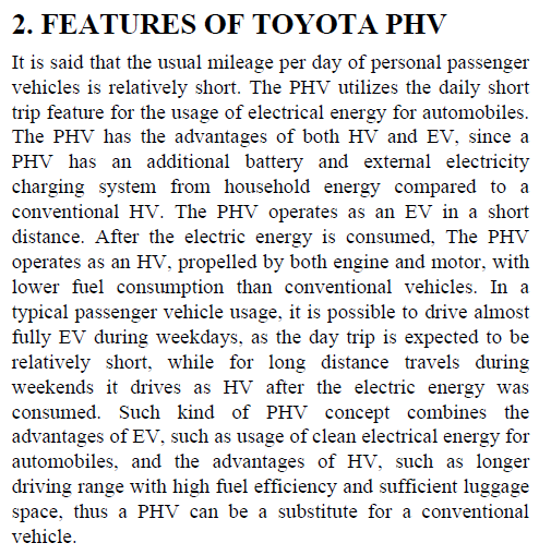

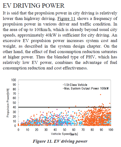

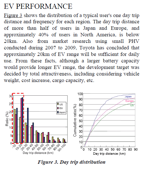

    See this post for Q&A with the PiP lead engineer. You posted in that thread so you must be aware. I think this one answered it.
    Q: How did you choose the pack size, since you get only 9 to 15 miles of electric range-versus 25 to 40 in, say, a Chevrolet Volt?​
    A: For the plug-in Prius, it was very important to optimize efficiency for all usages, and to retain the fuel efficiency when operating in hybrid mode. A higher electric range means more weight from a heavier battery, which hurts fuel economy, as well as less space inside. So, we try to make the most efficient vehicle in all operating modes.​
    Below is a few snips from SAE paper 2011-37-0033 to support my posts. To me, short trips = city driving. European PiP has EV City button for that purpose.

    In the article you cite, the engineer clearly start by saying" optimize efficiency for all usages, and to retain the fuel efficiency when operating in hybrid mode." The gets into weight and space.
    I.e. he is saying they were not willing to sacrifice hybrid mode efficiency That is not optimizing for the usage of both fuels, its optimizing what they could do in EV without impacting hybrid mode.
    The second statement from the engineer was that they try (not do) to make "the most efficient vehicle in all operating modes". But such an optimization does nothing to actually optimize the use of both fuels (which is you content was their design goal) which requires deciding which mode to use when. Nor does such a design produce the optimal balance between modes. To me that Q&A came across as suggesting they did a classic decomposition approach to complex engineering. Separate into parts (HV is an already proven subsystem, so minimize changes and don't loose anything there. Keeping the HV components the same, then do a some constrained optimization on the remaining elements. 62 MPH is not a magic efficiency number, it is set by the limit of the reused parts in their current configuration. Nothing wrong with engineering around cost and reuse of subsystems, just don't confuse that with optimizing for overall fuel efficiency.
    The EV city button is because of taxes for nonEV veichles in downtown such as london, have to ensure it will not use the ICE or face fine. (Though if the battery is too low the even using EV city button will not stop it"
    The short trips do nothing to support your theory. In fact the article directly contract it and says
    Optimizing the use of both fuels (or even optimizing anything to do with efficency) is not listed as a reason at all!
    This is a perfectly fine business strategy and their sales don't have to be great to recover the reduced R&D /design/manufacturing costs that approach produces. But lets not confuse it with an attempt to actual optimize the use of both fuels or the overall efficiency of the vehicle.
