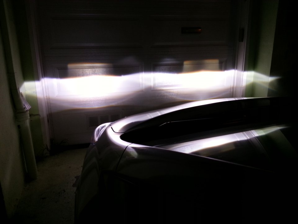

    I'm new to the Prius, as of last week, and I just bought the DDM 35W 5K set.
    Anyway, I'm really curious if anyone has an idea what the squares are on top of the headlights, right above the cutoff. Mine, of course, does this as well.
    I've never seen anything like this. If it weren't for those squares, the factory Prius projectors have a really decent cutoff.

    Yes, they're commonly referred to as "squirrel finders". :D
    The squares of light are from little cutouts in the cutoff shield that allow some light to illuminate above the cutoff. The idea is it will illuminate overhead road signs which would otherwise remain unlit if a solid cutoff shield were used.
    Another PriusChat member has retrofitted HID projectors in his headlights and has remarked that road signs are difficult to see. This is because those projector's cutoff shields don't have the "squirrel finders".
