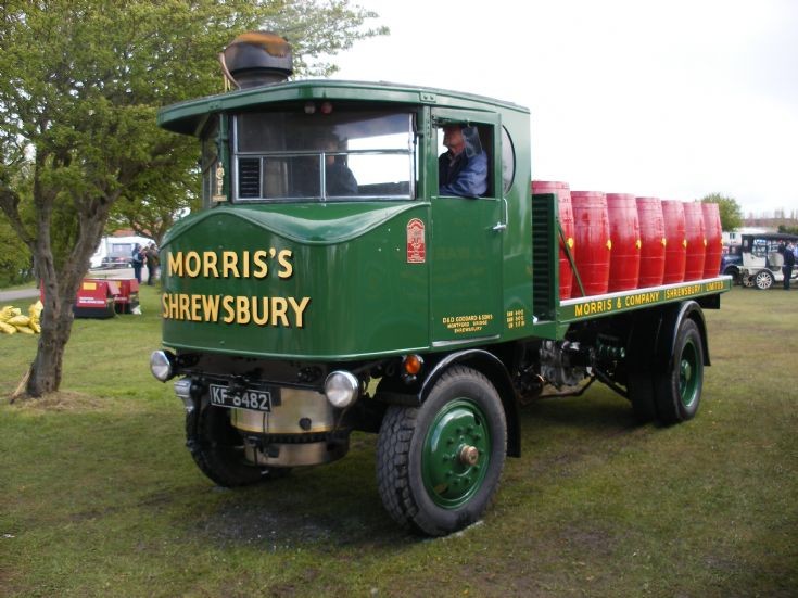

    Sounds like a VW diesel loving troll to me. Diesel as a fuel is dying as it's too nasty other than for trains and trucks where there is no alternative. Diesel has some benefits but many many disadvantages. Steam engines also had some advantages, but their downsides made them obsolete. I'm sure there are folk out there sinking the praises of steam too.
    "Who needs diesel? My steam truck is lovely and warm in winter and coal is plentiful"
