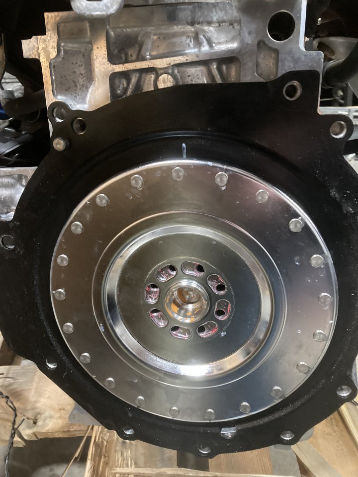

    I had to have a new flywheel made with the crank bolt pattern of the 2.0L yet the same diameter of the Prius flywheel so it would fit into the Prius CVT. That's how now we have lightened flywheels available for the Prius and the new 2.0l motor. Now, in my head what I know of to be the clutch in a manual transmission vehicle on the Prius is called the damper assembly, right? So when you say clutch we are talking about the same parts right? The clutch is lying on its side to the left of the motor next to the wheels right?

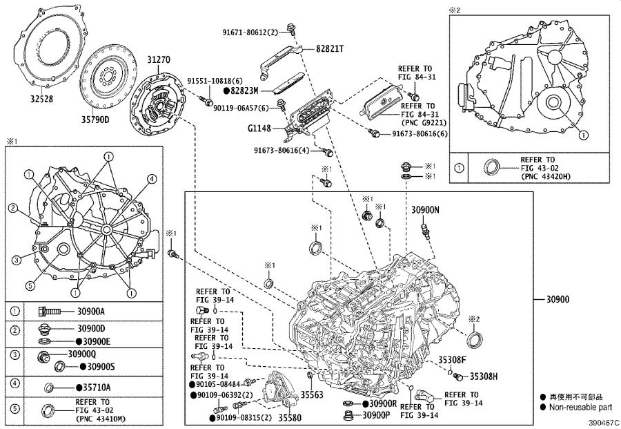

    While we're rolling, I understand the v transaxle also has a pitch suppressor (probably not the right name) but I had understood that to be an electronic feature- something in the MG2 inverter control. The idea was that it could dampen or eliminate rhythmic pitching sensations related to the longer wheelbase of the v.
    And just other stuff to think about: does the v transaxle inverter(s) give you what you need with respect to air conditioning and power steering?
  8. black_jmyntrn
    black_jmyntrn Senior Member
    Oct 23, 2020
    1,729
    410
    2013 Prius Plug-in
    not too sure about that one Mr. Foot... I'm a visual guy and after taking all this apart to build my Tesla eater.. I need to see it.. this image below appears to indicate we are speaking about the same...

    I can't really vouch for the picture in an old Prime marketing brochure.
    But the important part is that you're able to spin the planet carrier freely and easily without making the engine turn. If you were to try back-spinning the planet carrier, it would immediately dig in and force the engine to rotate.
    With one-way clutch: EV mode goes as fast as the battery allows
    Without one-way clutch: EV mode cancels/stops being useful from about 40mph on up... engine starts and helps out from there to the top of the speedo.

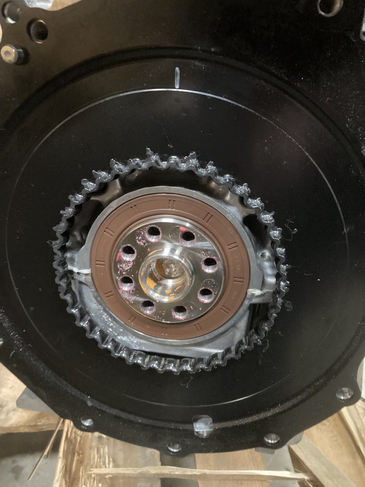

    If you take the flywheel right off a Prius Prime engine, you see this on the back of the engine block:
    Notice the circle of fixed teeth around the crankshaft bearing. (They look sloppy because of grease on them. They look tidier without the grease.)
    That right there is the (PNC 32528) "1-way clutch holding plate". It's just fixed, immovable, bolted down on the back of the engine block.
    If you then put the 35790D "1-way clutch assembly" back on and take a picture of the boring side, it looks, well, boring, and you don't see what's going on with the teeth.
    The less boring side of it is the other side, but the member who started that thread didn't take a picture of the interesting side, and there don't seem to be a lot of other pictures of it in the wild. Oh, well.
    But there are generic videos on how sprag clutches work:
    In the Prime, of course, it's the inner portion of that clutch that is fixed: the teeth on the fixed holding plate. The rotating part is the outer part and is able to spin freely in the normal engine-operating direction, but will engage the fixed teeth and never let the engine spin backwards.
    When the engine is turning in the normal direction, those little sprag elements in the rotating part are held outward by centrifugal force and they don't even contact those center teeth, so there's no added friction or ratchety noise.
    So, the sprag clutch is something you see on the back of the engine block, and on the engine-facing side of the flywheel. It isn't anything you see just taking the transaxle off, or looking at its damper, which goes between it and the flywheel.
    The parts diagram above is funny, because it shows both 1-way clutch pieces, and then next it shows the transmission input damper, and it doesn't show the engine flywheel in between the clutch pieces and the input damper! The flywheel gets its own picture over in the crankshaft and pistons diagram, and that one doesn't show the 1-way clutch. :)
    It also is not my understanding that the sprag clutch does anything to change the nomogram of the transmission. All of the familiar relationships between the speeds of the engine, MG1, and MG2 have to still hold. At high forward speeds without the engine turning, MG1 still has to do some pretty high reverse revs. If they have raised the road speed they allow with the engine stopped, they must have raised the limit on MG1 revs, as a separate refinement from the sprag clutch.
    What the sprag clutch does is let them go further and use MG1 in that situation, to contribute more torque. If the sprag clutch weren't there, that would only spin the engine around backwards, a waste of energy (never mind how well the engine tolerates spinning backwards). But with the sprag clutch, the flywheel digs in then and won't budge, so the MG1 power acting against it has to be contributed to the transaxle output.
    But if you add the spraggy teeth and 1-way bit on a car that didn't have them, the programming in the power management control ECU still won't know it is able to apply MG1 torque then without the engine spinning backwards, so it's still never going to try.

    This picture is concerning. This is with the flywheel pushed over the plate and all the teeth from the other image right? or does the flywheel and pressure plate go on top of this? Because this flywheel looks nothing like anyone I've seen for a Prius nor the new 2.0L from the ux250h
