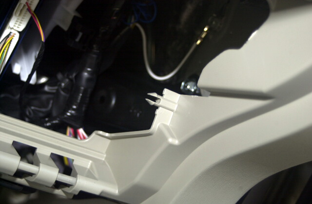

    I watched the video again and except for the filter itself, the glove box door removal is the same as a GenIII, one damper on the passenger side. If the damper is missing, the mounting is the same as on the door, and can be seen on the side of the door frame.

    Here's the mounting stud, in the center of the photo.

    Thanks, but the picture is too small to see it.

    A blind man could see it with a stick. It's the light color protuberance in the middle of the picture that looks like two pieces pointing to the left.

    I'll look at my car and compare it to the picture or just look around with a flashlight to see if I can tell where the damper goes or else try to find a diagram online. I still don't see the damper in that photo.

    The damper is removed so you can see where it mounts.

    I know where the front of the damper is supposed to release so you can remove the glove box door access the filter. If it didn't fall off, I could have reattached it to the door with no problem. What I don't know is where the other end of the damper connects when you need to replace a damper that completely fell off.

    Circled in red below.

    Is there a photo somewhere showing exactly how the damper is installed? The damper has three holes on it and it also expands in and out. I don't see how to actually connect it to that spot. I tried several different ways and none look right to me.

    The damper is attached by the center hole to the circled stud in the photo. The piston of the damper is attached to the stud on the glove box door. The top hole of the damper isn't used.

    OK, thanks. That was one of the ways I already tried and I couldn't believe it would be supposed to sit that precariously in that position. It doesn't snap into anything. No wonder it was so easy to accidently knock it off onto the floor the first time i was reinstalling the glove box door.
    I pulled the damper to the extended position and tried it again and it works now.
