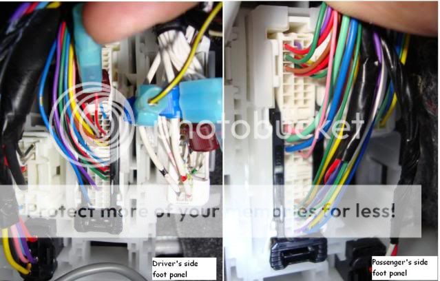

    According to the door sill instruction, the puddle light source (e.g. driver's side diagram shown below) is located at the foot panel.
    I'll look further into the steering column panel until I found the 96-pin connector tomorrow during the day. I assume none of these at the foot panels neither although my car went totally dark after unplugging that 64-pin connector on the driver's side.

    It looks like that should be the OL1 junction connector, and there should be a similarly wired junction connector (NL1) on the passengers side. That's the right red wire that we can use for the hot side of the mirror welcome light. Do not use the yellow wire, it is the return from the door puddle light and uses a different grounding circuit.
    When you follow that red wire back under the dash, you should find the large 3B connector. It probably has a big bundle of wires connected to it. If you can't get to it, you can try finding the UL1 junction connector or the 2A connector to the Main ECU. The UL1 should be a nice-sized gray 18 pin (19x2) connector. Since it's heading to the roof though, I fear it may be up high into the dash. The 2A connector is an elongated 56 pin white connector divided into 3 sections along its length. Along one edge are a series of fat wires, 6 in each of the two outer sections and 2 in the middle section.
