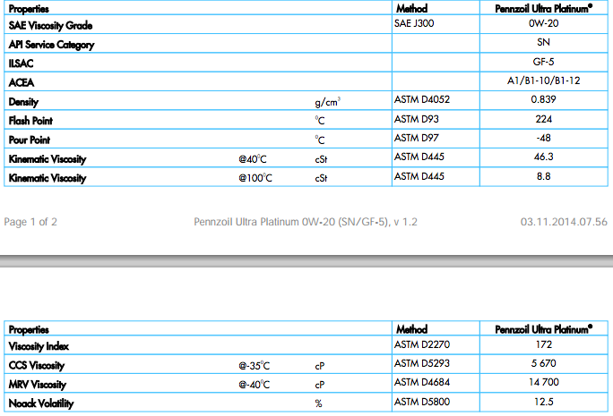

    This is the Pennzoil Ultra Specs. Available at Walmart :)

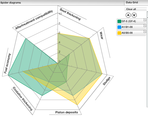

    This is a cool tool to compare oils and specs:
    dataStack
    From the tool, looking at ACEA A1 and A5, and ILSAC GF5
    The colors are misleading. GF5 improves fuel economy and oxidative thickening
    Note the after treatment compatibility ;)
