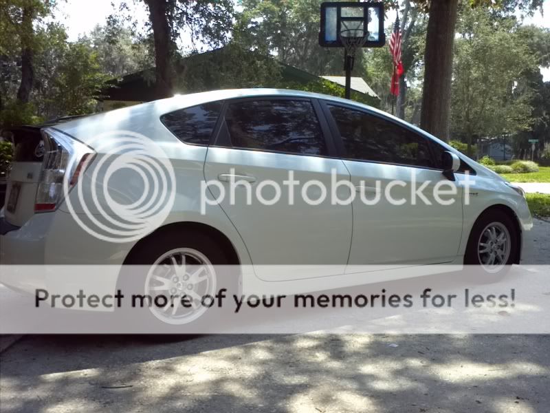

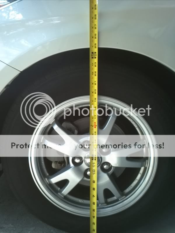

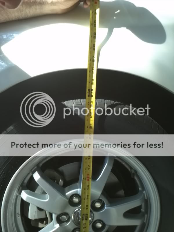

    Awesome, thread! Thank you so much. Just to confirm, the nut size for the fronts is certainly a 22mm (mine is a 2010).
    Here are some pictures of the front wheel gap. I apologize I didn't do the before measurement on the rear.
    Before front:
    After:
    Completed. Next weekend the Celica GTS 5 spokes go on with 205/55/16's:
