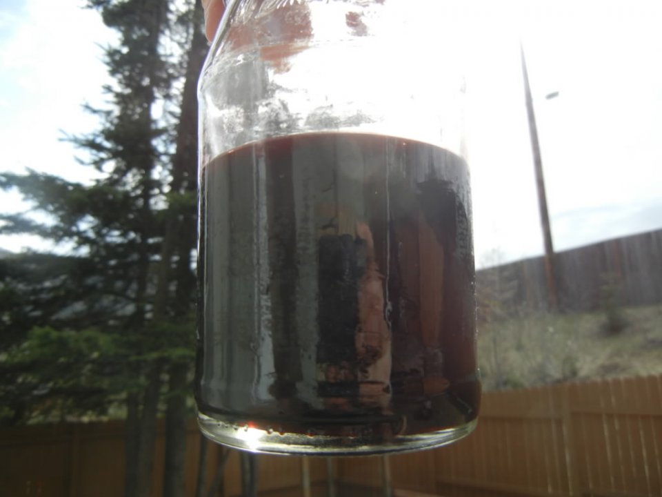

    Finally leveled the car along both axes (using front threshold as a reference on length side, as suggested). Opened the fill plug and let it drain for about 15 minutes. I had begun to fear the worst, but I didn't get very much. Probably less than a pint. Here's the pic:
  14. frodoz737
    frodoz737 Top Wrench
    Aug 26, 2010
    4,798
    2,560
    Definitely was worth it then. :)

    DSCN2297.jpg Well just finished replacing the fluid. Had to run and get more hose (needed 2 feet worth) to reach the fill hole. Took about three hours but I also removed the undercover.
    The fluid color was about what I expected and is shown in the photo attached. 44K miles. Nice to have it done but in my case, not sure it was really needed it.

    Nice stuff, looks like two day old coffee that somebody left on the burner. :)

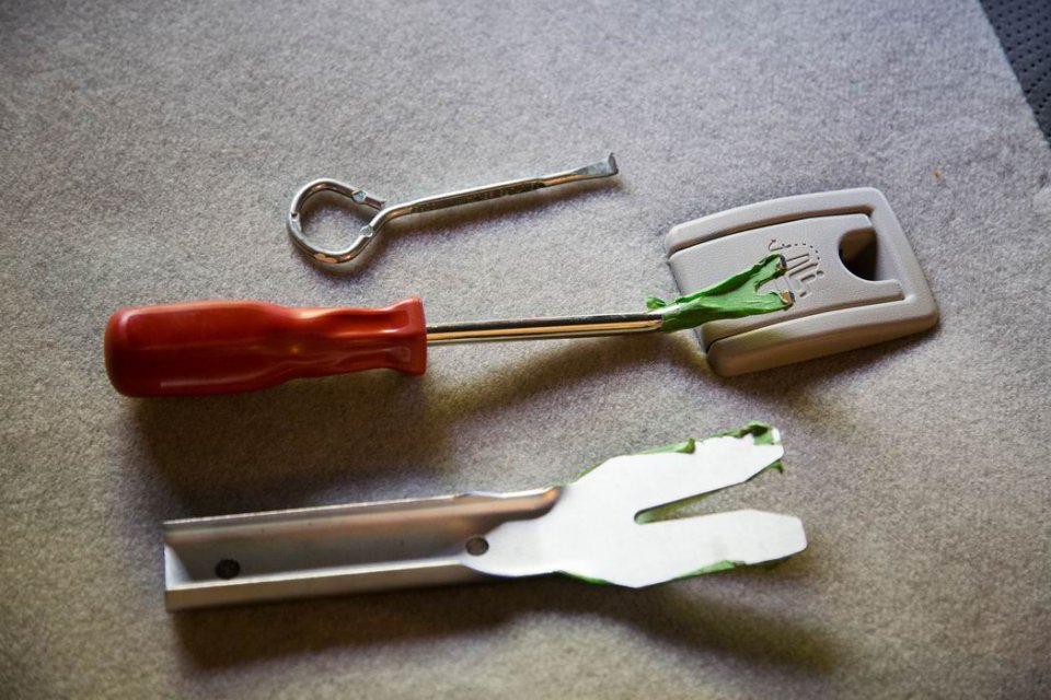

    Did the same thing today at 43K. Color was so dark. Glad I changed it today though. Ended up breaking a few plastic tabs.

    You can get them at the dealership, they're a common replacement item. One of these is hand for pulling them off:
    (top item in above)
    Also, when you have them off, rinse the grit out of them, makes them less prone to seize.
