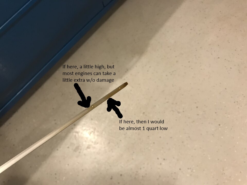

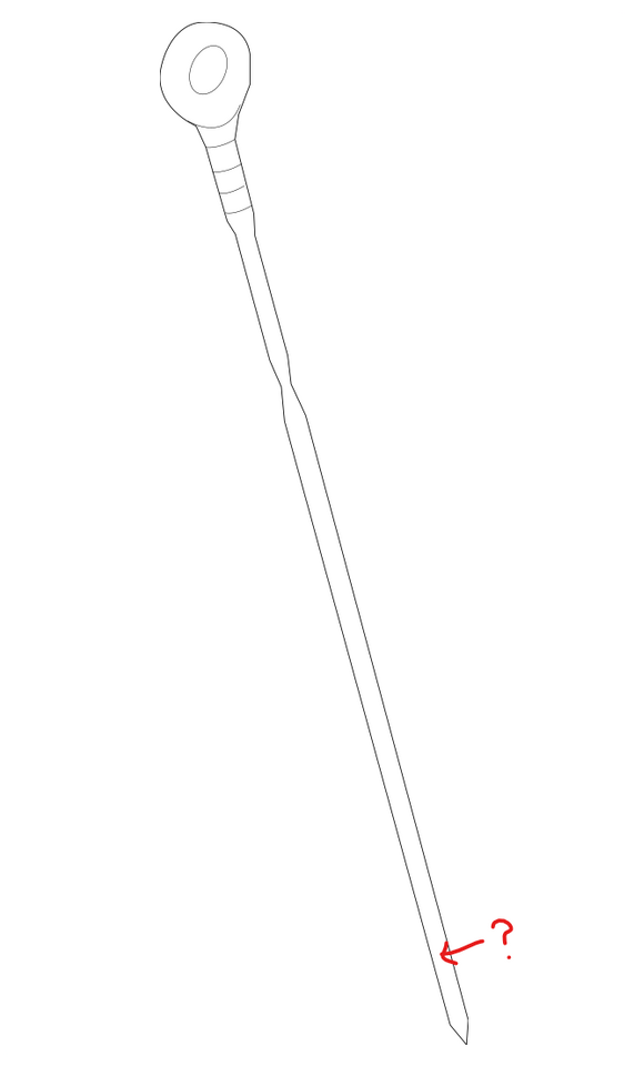

    To add to this thread, I let the car sit overnight (neither on a charger or been running for 8+ hours) and checked the oil, still at the "Full" mark. After doing some searching, however, I noticed that the dipstick I should have doesn't seem to have a mark at the "Full" level, which I've marked up on the photo attached.
    This was just from a quick Google search showing the dipstick I should have (1530137010):
    https://parts.toyotaofnashua.com/oem-parts/toyota-2008-2024-toyota-engine-oil-dipstick-1530137010
    Can anyone confirm/deny that their 2017+ 4th Gen Prius Prime dipstick has the mark where the ? annotation is on the attached photo?
    I'm now wondering if I was very low on oil (3 quarts or less in crankcase) or if I am now way over full. If it weren't for a slight injury I'm recovering from, I'd jack up the car and drain out all the oil just to be sure.

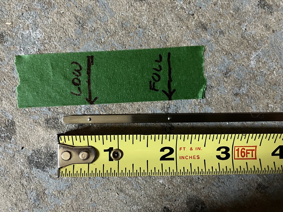

    I checked on Amayama, my 3rd gen is the same part no for dipstick; pictures for comparison:
    oil at the full mark:
    Regarding the relentless readings as “full”, something’s not adding up: if you (say) add a pint of oil, and the level doesn’t budge on the dipstick, you must be doing something wrong, or reading the dipstick wrong.
    Addendum: per the US 4th gen Owner's Manual (on page 593), distance between the two marks on the dipstick represents 1.6 US quarts.

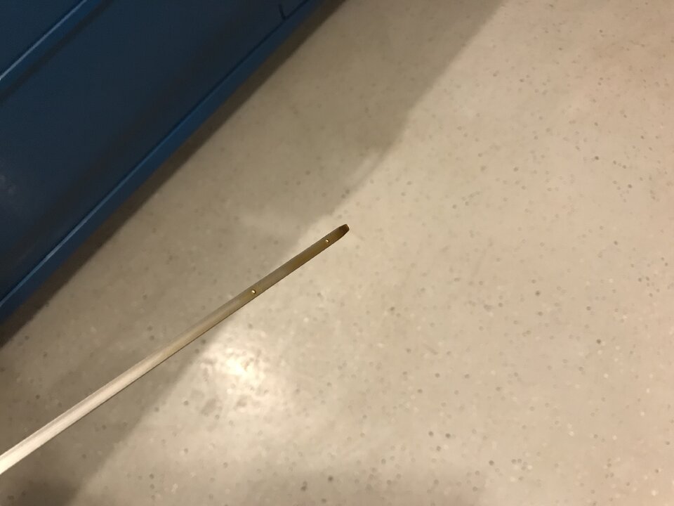

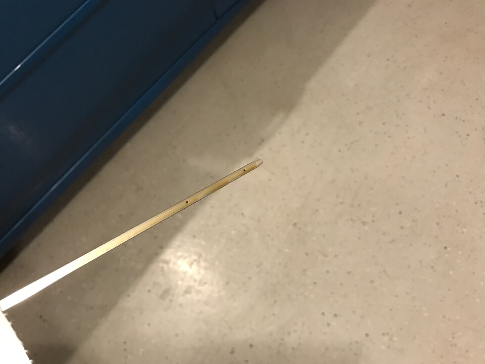

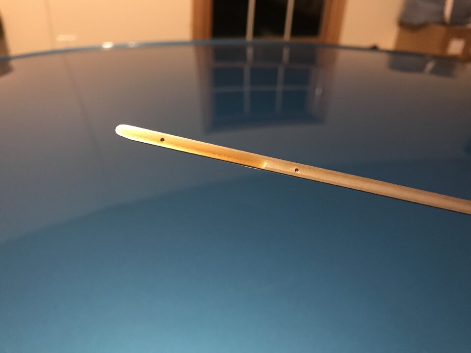

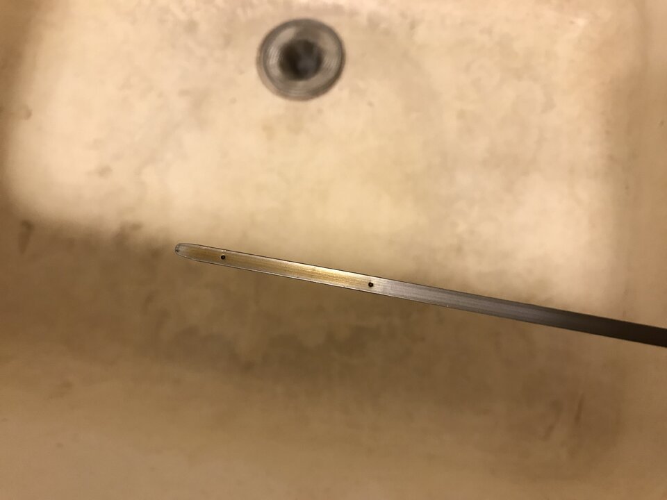

    Here are photos of the dipstick, after being wiped off with a clean rag. I just drove 30 minutes so not all the oil has had a chance to drain back into the wet sump.
    Also, I just noticed that if you flip the dipstick over, it actually reads way high - something I’ve not seen before.

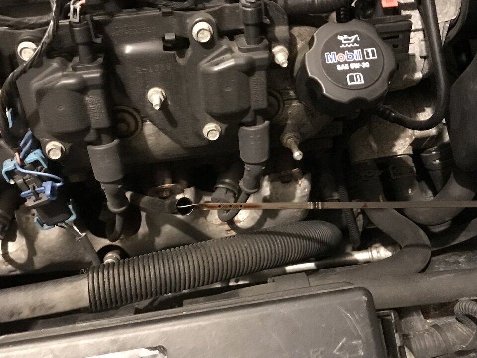

    For comparison, attached is the dipstick for my track car (2009 Corvette LS3), where GM says to overfill the oil by 1 quart (it clearly shows overfilled, and the distance between the middle and top dot is 1/2 quart). This dipstick shows the same thing regardless of orientation.
    With the Prius, both sides are not equal to the top dot - am I way over on the Prius, or way under?
    Photos: 1. Prius Prime dipstick pulled straight out, 2. Prius dipstick flipped over
    3. GM LS3 with known 1 quart overfill (per manual), 4. Cub Cadet 243cc dipstick

    Here is another reading back to back showing it right side up and flipped over. Which is correct, the first or flipped orientation?

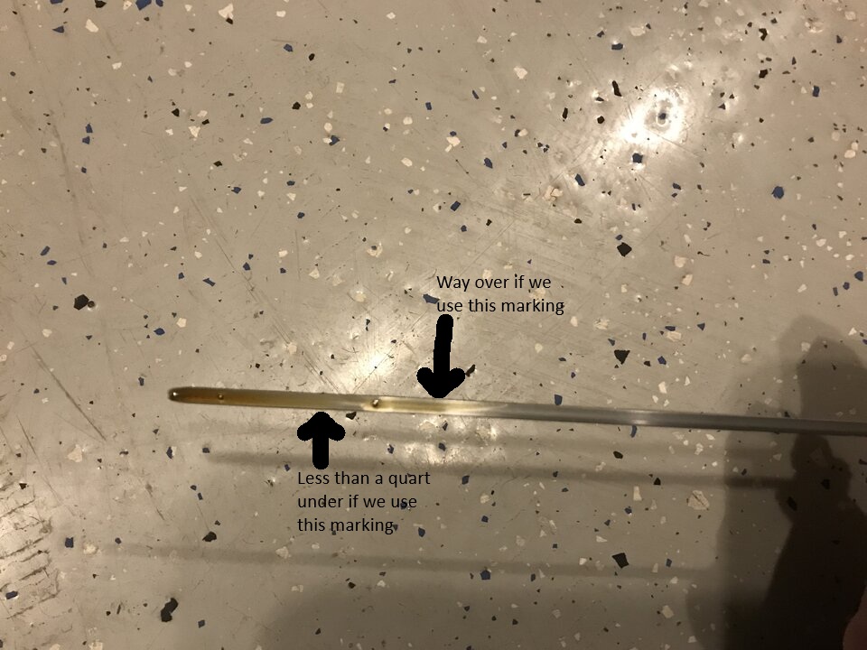

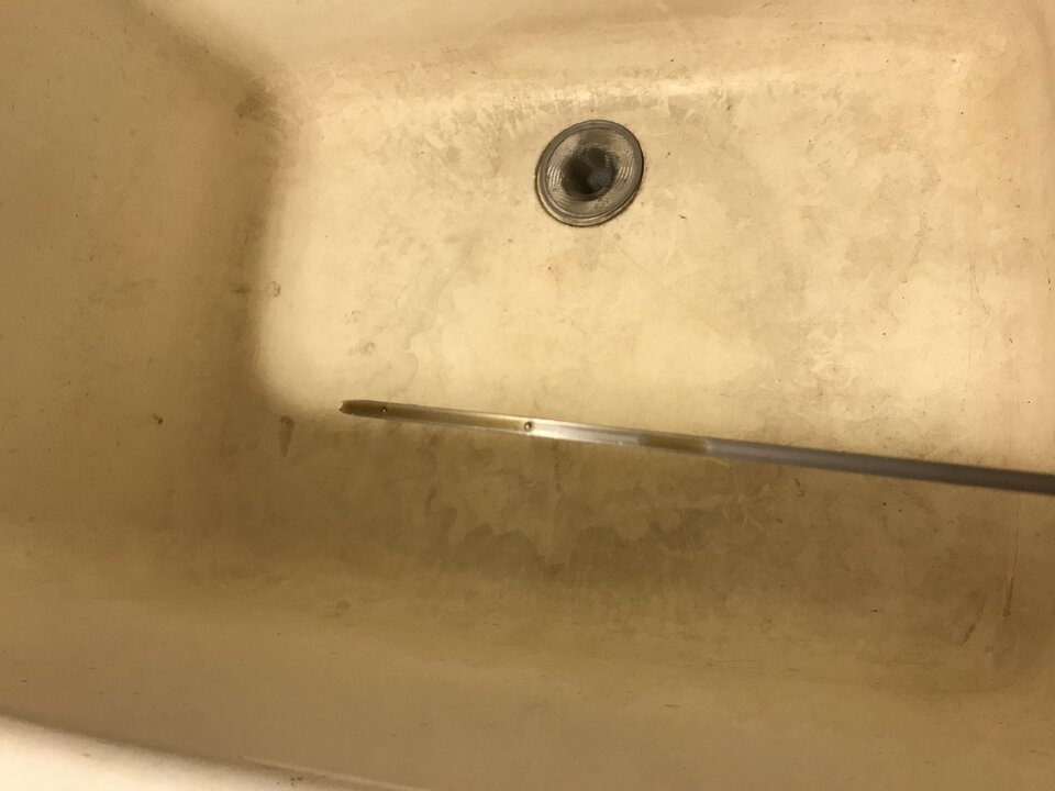

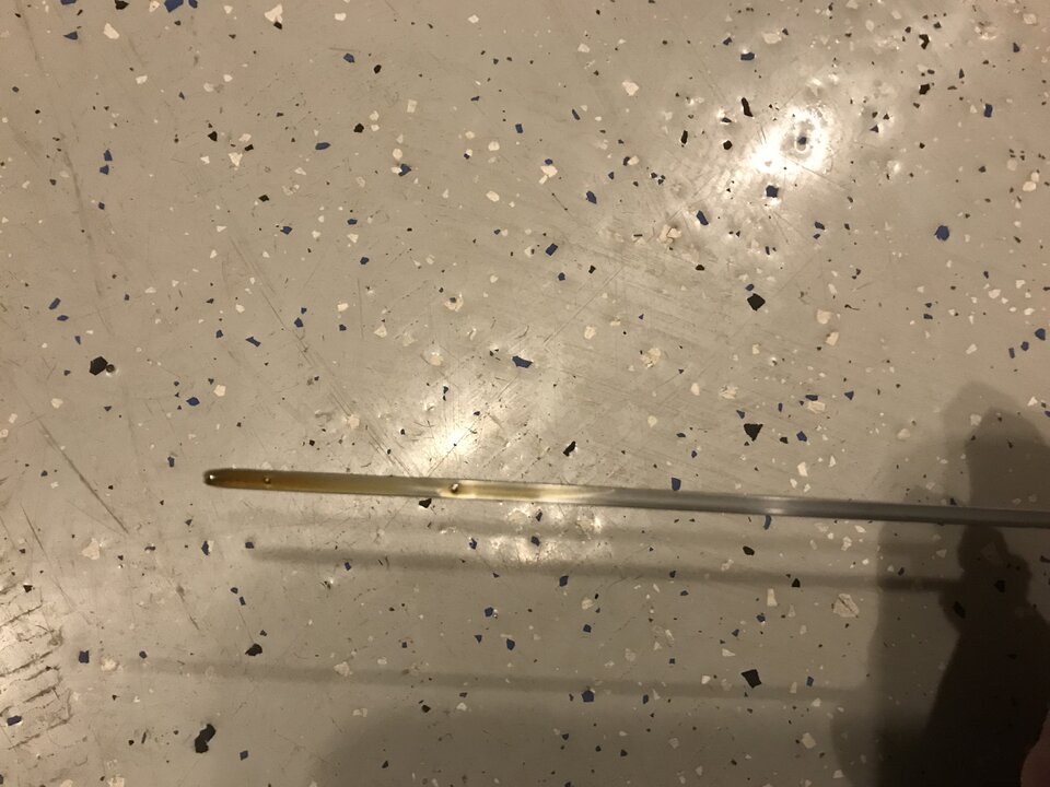

    I made some markups based on what I am seeing, in both cases (flipped vs, not flipped) the dipstick leaves open to interpretation which reading is the actual reading.
    Wiping off the dipstick with a rag doesn't seem to correct this, I always get two "spots" where the reading could be assumed to be Full.
    This is the forward-facing orientation:
    Then after flipping the dipstick, we get this:
    Really hope I didn't run this engine low, it's my baby, and if it was burning oil I feel like an idiot & should've just drained the oil out to begin with. Then I'd know 100% what's in the crankcase.

    I will check the spark plugs when I have a day off. Let the car sit overnight and I’m back to the “It’s Full” on one side and over on the other. Maybe I really was a quart low and should have been flipping the dipstick over the whole time?

    After pulling the dipstick, wait at least 5 minutes before pushing it back in for the level check; the first pull-out tends to pull oil up the tube, and the wait gives it a chance to drain back down. Otherwise it’ll smear some oil along the dipstick, much higher than the actual level, making it difficult to determine the actual level.
    also, I’ve found the dipstick face towards front of car tends to be more definitive, less prone to the smearing.

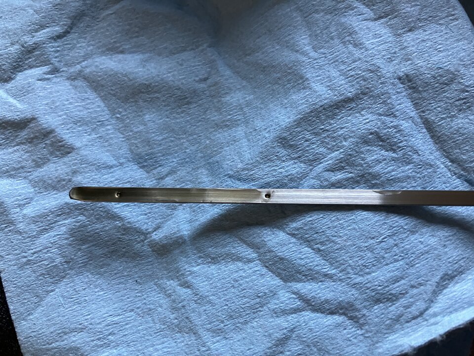

    Thank you, it looks like I’ve actually been a quart low as I tried your method for the first time. It still left oil streaks, but I can clearly see its now at the Full mark (flipping it over reads way high still) so I guess the whole time I was low, just like the Reddit post I referenced above.
    Hopefully no engine damage was done, and my cold start rattle seems to be gone for now. I’ll still check the plugs when I’m able to, it’s a 4 cylinder (a lot easier than Camaros and Vettes where the last 2 plugs nearly require wiper arm removal, lol).

    That’s the issue, I was always at the “B” mark until I tried what @Mendel Leisk had suggested.
    The whole time I saw “Full” then realized it was just residue from the tube. Basically the true level was likely close to “A” but the smears kept it right at “B” which was confusing.
    Luckily nothing seems to have happened, but only time will tell.

    Always read the lower level; the higher side is oil smearing from the dipstick tube.
    On my cars, if I read level first thing in the morning, both sides read the lower level.
    Odds are good your engine is burning oil. A good engine can go 5k miles or more with no observable drop in level.

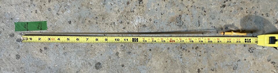

    The attached photo was taken cold, 3-1/2 hours after the ICE was on. The vehicle is level in the garage. I removed the dipstick and wiped it off and put it (in and then out) of the crankcase. Note that the oil level is slightly about the top hole. The oil was last changed by Toyota 900 miles ago with 0W16. FYI, Corvettes have dry sumps so dipstick level is different than Prius’s.
    The only way to know for sure is to drain the oil and add a known quantity. Keep in kind that even if you warm the block and drain it, some oil will remain in the crankcase and if you don’t change the filter, oil will remain there too.
