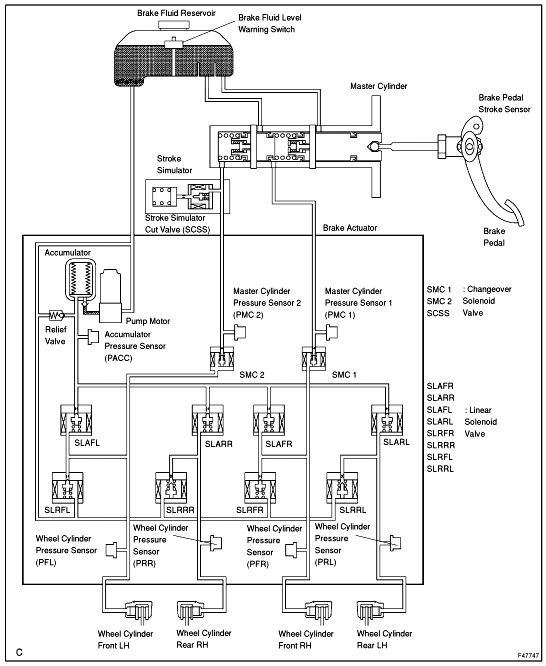

    Gen 2 Prius had separate pressure sensors measuring the actual pressures to all four wheel cylinders (plus two master cylinder sensors and one accumulator sensor).
    Gen 3 has no wheel cylinder sensors. It does have a single "front wheel cylinder pressure sensor" for the pressure supplied in common above the FLH and FRH valves (plus one master cylinder and one accumulator sensor).

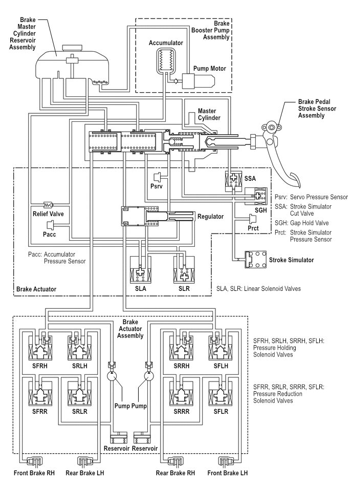

    Gen 4 has only accumulator, stroke sensor, and servo pressure sensors.

  19. ChapmanF
    28,731
    19,027
    Psrv would be the closest available proxy for what's going out to the wheel cylinders, but there's only one of it, and it's too far upstream to tell you what the ABS actuator might be doing to vary the individual wheel pressures.
