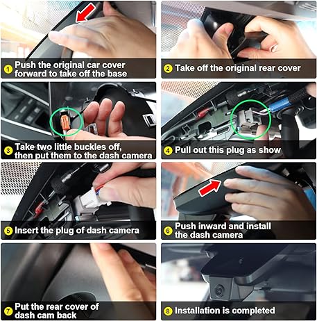

    PIcs of this cam which seems to tick all the boxes: easy install, full featured, phone APP accessible, OEM appearance, etc. etc.
