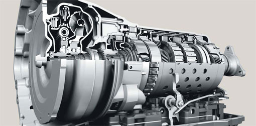

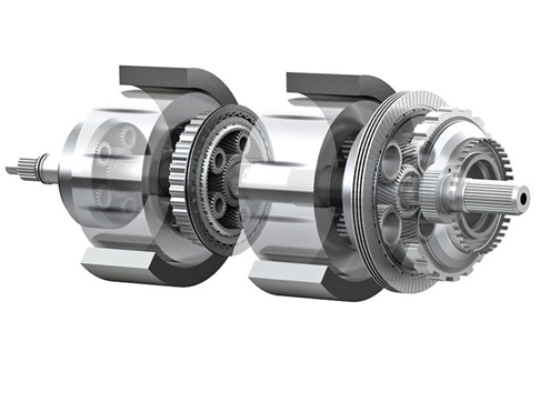

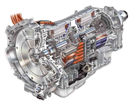

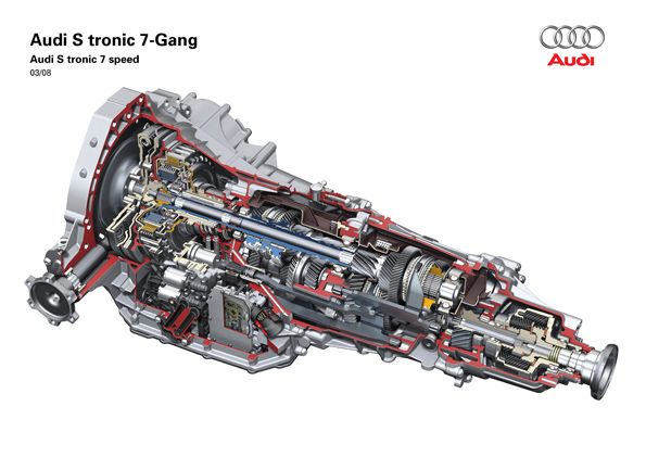

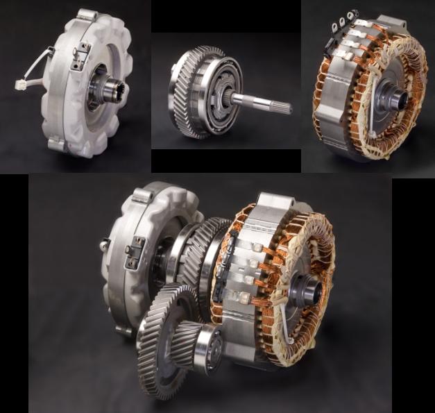

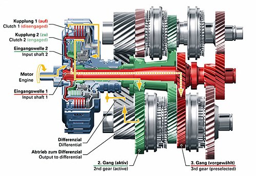

    Here is the Gen3 Prius hybrid transaxle. You are looking at motor/generator #1 (MG1), Power Split Device (PSD), motor/generator #2 (MG2), and finally the reduction gear.
    Up next is the GM's 2-Mode hybrid transaxle. The first picture is just the motors and planetary gearsets. The second picture if the entire transaxle.
    Below is the bare-bone Dual Clutch Transmission:
    Audi 7-speed Dual Clutch transmission:
    Now, going into "traditional" 8-speed transmission:
