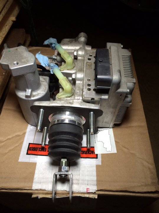

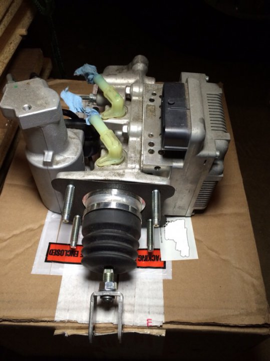

    Thanks jdcollins5. I've replaced my master cylinder this weekend with a 2011 unit from ebay. It is pretty straightforward job except bleeding air using techstream(keep losing connection to ecu) since I've never done it before. It took me about 4hrs to complete working at a relaxing pace. The master cylinder stroke seems to be shorter and brake feels is much much more improved. I also feel more confident in braking power and response(gear in neutral and no regen). Not sure if it is more sensitive pressure sensors in the replacement part or just placebo effect. Total cost $225 + fluids and my labor (and possibly an accident 2 weeks prior to 1st failure - long story)
    I also looked at the inverter parts on ebay and they are around $500 so it's not too bad if it comes to that failing also. I guess this is the fun of owning first year car.
    Here is the offending part that Toyota put in our 2010's. :)
