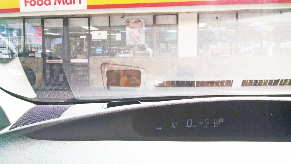

    It looks like the eye point in the picture is very low. It's as if you're looking at the road from just above the dash. If I was able to move my seat that low, I'd have the same issue. However, if raising the seat to eliminate the problem causes leg cramps or other physical issues, then there really is no cure from what you've posted.
    Not to sound insensitive, but are you very short?

    I've noticed that the windshield (windscreen) on the Prius has an annoying, inherent haze due to the extreme slope angle. It makes an ideal reflective surface for anything to show up: even the defrost registers. Toyota has used a highly defused dash material to minimize the glare but should have focused (NPI) on their glass glazing process. IMHO, there is a lot of room for improvement.

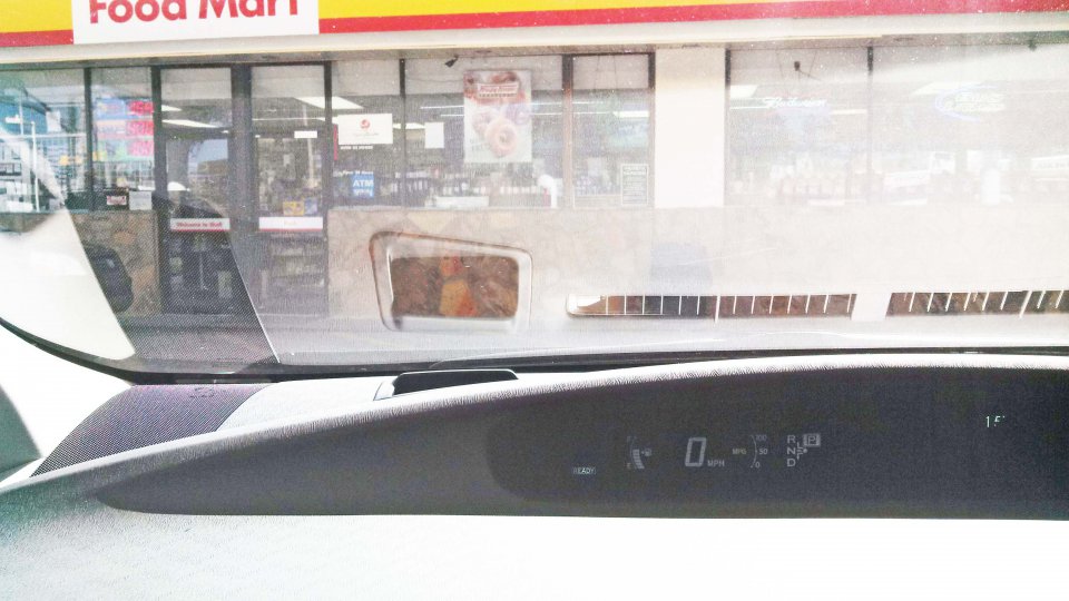

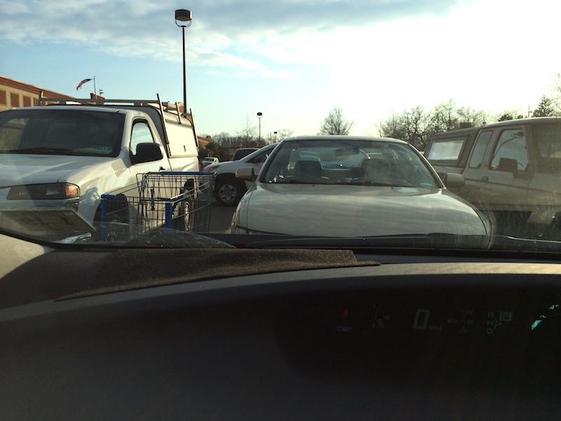

    A 33 Cent Partial Solution to the 2014 Prius Four Heads Up Display Glare Problem
    Like the OP, I also just got a 2014 Prius Four. I got it mainly for the heated seats. I didn't care about the HUD, but it happened to come with the car and I didn't think much about it.
    When I got the car, I tried out the HUD but found it distracting to have the writing right on the windshield. I don’t always need to see my current speed or to see what turns are coming up on the GPS. They don’t need to be projected up to the glass. And the normal speedometer and nav system aren’t so far away anyway. So I turned off the HUD.
    Even with the HUD off, the HUD outline on the dashboard created a distracting reflection on the windshield. I searched for this problem online and found this thread a couple weeks ago. I tried the suggestion about adjusting the seat height; but it didn’t make much difference for me. Slouching uncomfortably low helped a little bit but wouldn’t be safe. The severity of the glare seems to be related to the height and angle. I’m about 5’8”. My wife is about 5’3”, and she doesn’t see the glare in the windshield.
    One of the suggestions in this thread was to paint the dashboard with some anti-reflective paint. I didn’t want to do that to my brand new car (got it end of January 2014), but I tried a related solution. To try to reduce the reflection, I tried putting something non-reflective on the dashboard to cover the HUD projector. I had a red neck gaiter on me (it’s been cold in New Jersey). That was better than without it, but the red color was a bit too bright.

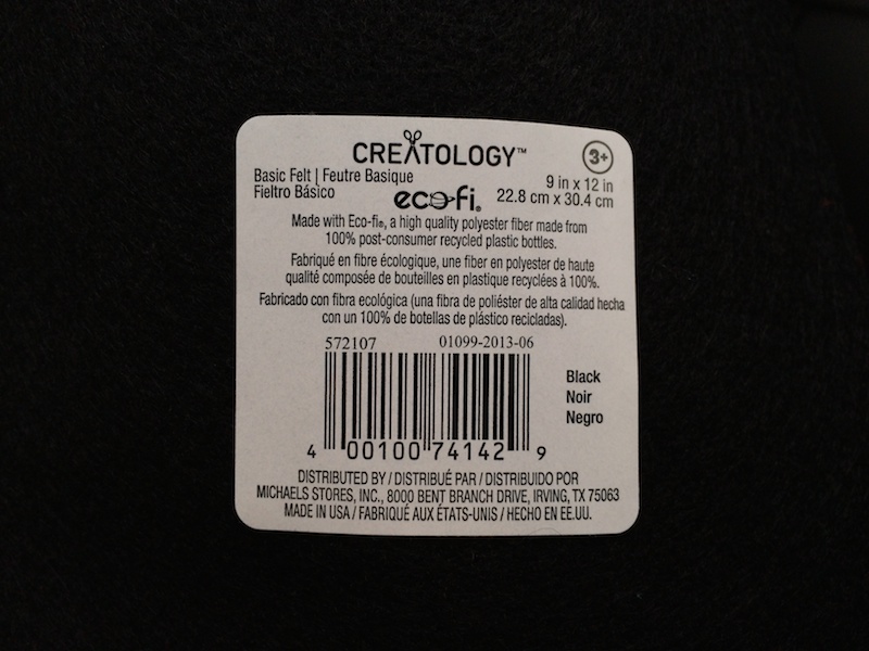

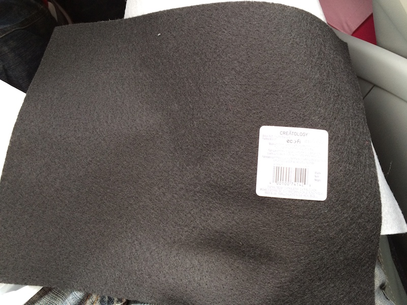

    So I went to an arts and crafts store (Michael’s) and got a piece of soft black felt for 33 cents and put that over the HUD projector. That seems to be working best. I can still faintly see a black rectangle projected onto the windshield, but it’s barely noticeable. The felt is 9 inches x 12 inches. It covers the vent a little bit, so I should cut it down (maybe to 9x10 or 9x9).
    I thought I’d need an adhesive to keep it in place. But it’s been staying in place the past couple days on its own. Probably because it’s protected from the wind. Static electricity may be keeping it in place too.
    My dad has an older Prius (I think pre-2010) without a HUD, and that doesn’t have any annoying glare on the windshield.
    It’s a shame that the HUD glare problem detracts from an otherwise great car. Hopefully Toyota addresses this for future Prius models.
    Thanks,
    Howie
    Prius with black felt covering the HUD frame on the dashboard:
    Label for the felt:

    That photo in the first post is rather ironic. The only area not actually obscured by dashboard reflection was the HUD opening, showing it really isn't the problem in that circumstnace. It does stand out in contrast at times, but is likely only an annoyance if you are a particular height. For me, it's not.
    This photo is what I see most of the winter...
    This video was filmed under conditions that would over-emphasize output, since washout due to camera frame-rate is a problem with that type of display...
    Black felt is what I use to prevent dashboard reflection while filming scenery through the windshield. That is a realistic solution, in all but winter driving (since it blocks the defroster). It stays in place, looks nice, and is very inexpensive.
