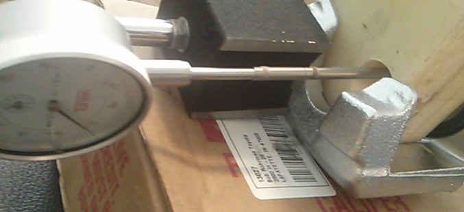

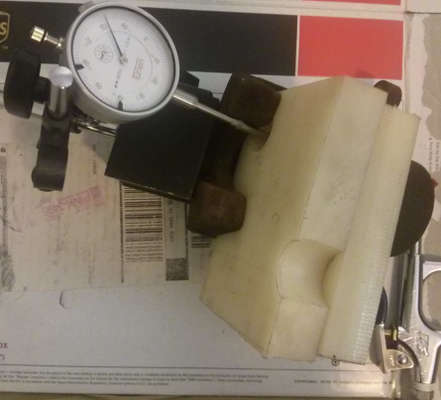

    Ever since I had a story like that giving me fits on my Gen 1, I made a vow I would always check the caliper piston return even on a caliper straight out of the box.
    (Note: Gen 1 calipers were cast iron, so a dial indicator magnetic base would work. More cleverness would be needed with the later generations' aluminum calipers.)
    Desert Flier likes this.
