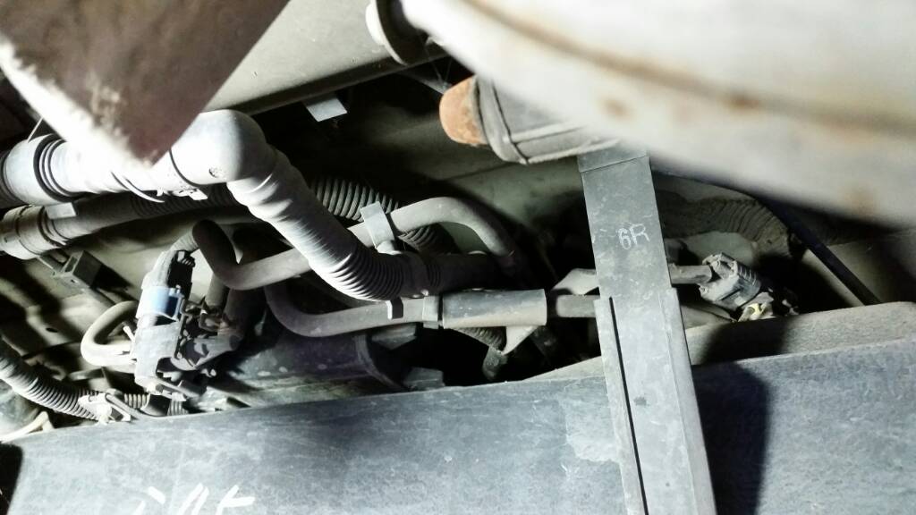

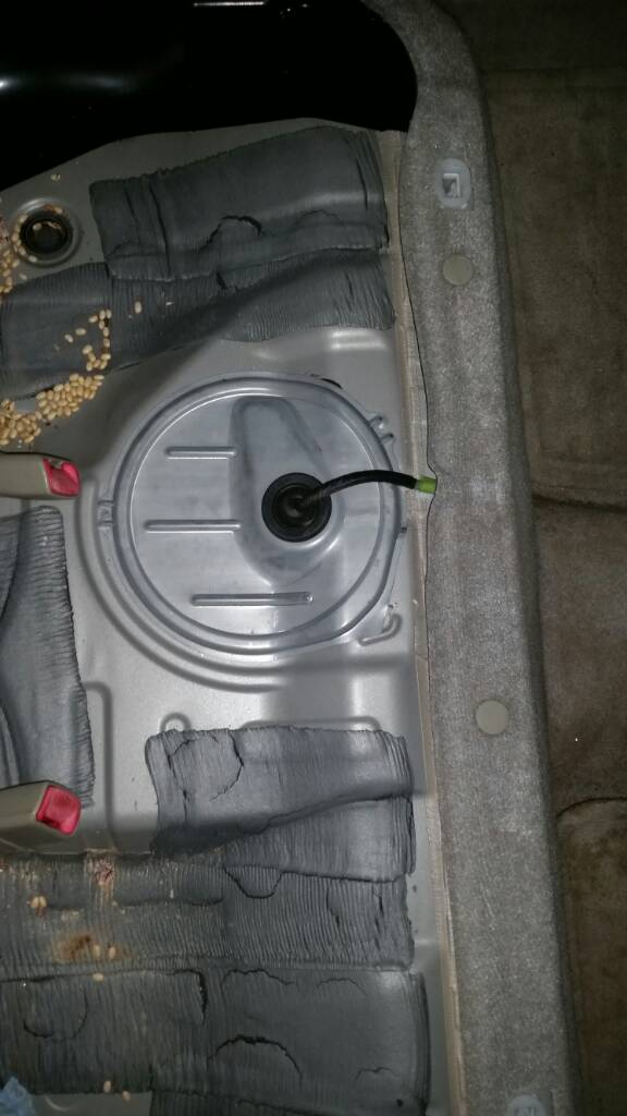

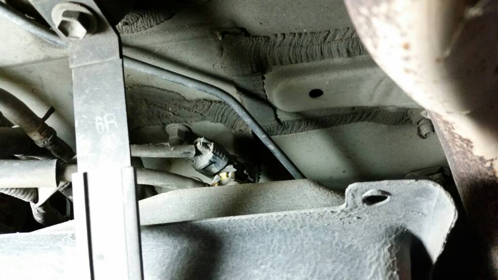

    This is all I am gonna say here because we discovered gas around the outside of the bellows when removing fill tube connection:
    Remove rear seat cusion assy then pry out cover in center with wiring and disconnect pump & sensor connectors (three). Don't loose rectangle gasket from grey rectangle plug receptical tank mounted side.
    Remove rear canister above axle but first disconnect all vacuum like emission lines bkt, then disconnect ftom tank area at front pass RH side fuel press & return lines, disconnect large fill line (no you can not siphon it fron this point) at RH rear tank last, caution if bellows has gotten fuel outside it will run at a faster than dribble and catch it with tub or pan. There may be a from a cup to couple quarts or more. Ours is at over a 1.5 qt at about 20 minutes in and still dribbling out (update over a gallon now). Use at least 2 people to go rearward and up and to pass side some to clear exhaust & emergency brake cables. Then down & fwd to go out with tank. Here are pics:
    This above is a swiveling connector with 3 wires and a black plastic clip needing removed vertically then at botton a yellow clip removed by prying with small screwdriver at both ends of the top of it. You will need very short tool for inboard side.
    Above is box & lines in ctr rear.
    Above is pic of fill port. Inside is a whitish plastic solid baffle forcing a 90 degree turn down to a much smaller round hole than the metal tank shell about 3/8" dia and a narrow slot running LH to RH about 30% of the circumfrence in rear area on a horizontal plane nearest aft DR LH corner making siphoning nearly impossible. Can not verify a screen as this may be assumptions of others part. There is also what appears to be a spring steel or CRS (stainless) circlip type retainer ends visible if you blow image up.
    Sorry man, but this is useless info in our case given the last post with pics I made. I am not buying a subscription unless I have to as I feed 6 of us and there are other ways of figuring it out. One reason is I do evrything mobile & the way a lot of them (diagrams / schematics are now set up for printing in books broken up too much or propritetary file systems or for huge monitors causing frustrating navigation problems. Besides in the time it takes to find that site pay them, look that stuff up I will be done with the job.

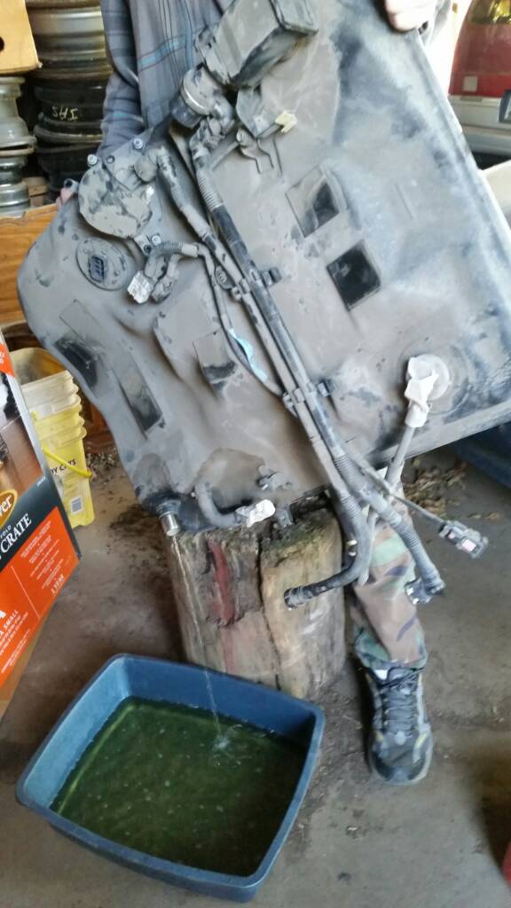

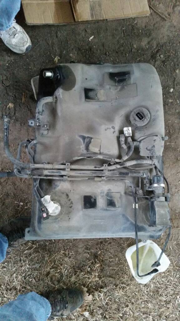

    1. When I decided that after inspecting tank & pump configuration it was not conducive to draining fuel by powering pump due to a much greater number of wires than is on any other vehicle in North America that I have ever worked on due to schematic availabity being an severe inconvience. The bellows tank being a seemingly inigma mystery no one seems to post much evidence real experiene dealing with. Lack of proven alternate established methods outside of dealer shotgunning of draining or maintaining tank, canister & pump. Given the commonality of how often the bladder gets fuel overflow condition and history of the driver being poor and it being a company issued vehicle the chances of abuse causing this bad tank probem were very high. If I pumped it empty and still had fuel in between shell & bellows then tank would still need pulled wasting the pumping effort.
    2. The fuel runs out in a small stream due to bellows pushing it out, physics of surface tension & fuel floating on denser objects (bladder) when not allowed to flow lower around it due to lack of space from spring like action of bellows. We helped scavange it all tilting it up in ever invreasing angles every 40 minutes or so for next several hours using objects to block it up over a pan.
    3. I have scoured the internet and the likelyhood of the bladder rupture based on the severely lacking of high quality of owners descriptions reporting the problem verses the human error, (human factors) and ingorance and blame game, verses Toyotas quality problem defect percentage being very low its a safer statistical asumption (given I never like to guess it was my best gamble) the tank bladder was flooded. Simply put Logic based elimination. Agreed about casister. If when refilling tank we get fuel guage failing to be accurate after calibration cycle and tank does not take normal qty then we will have confirmed ruptured bladder but we are not doing that unless we have to. There are 2 at the salvage Gen 2's so no biggie just not wanting to waste a dime at this point.
    Was kinda under the impression these issues were getting pretty obvious but not everyone is willing to get as dirty and banged up learning as us. Just IMHO. Thanks for the curiousity.
    We are at over 5.5.. no edit see pic for technique for when tank is mostly empty update over 9.7 ish gallons removed.... If in unlikely case bladder is ruptured we will do & post a Youtube style tear down vid cutting it open near the center flange while purging vapors.
    I am very sure he did a fill up right before the wreck now. Had to explain to the boys why fuel does not slosh. Finally going back in with tank. About 26 hours later of which about 6-7 hours was slow draining. Man that evil fuel guage calibration circuit :-(
