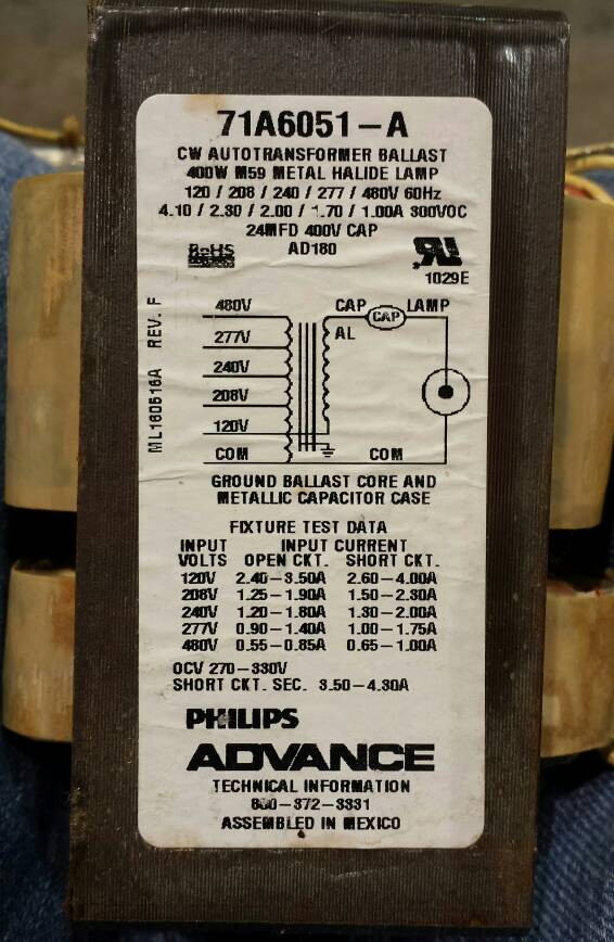

    We are humbled at this point & seem to be in need of further cell rehab as most cells are not holding amp drain long enough between 8.54-8.76vdc down to 7.2vdc ish to be satisfactory to my or the Prii liking. My searches for something in the correct capacity range on Ebay reveals no affordable options. Therefore since the small desulfators I use take an extremely long time (2-4 months) to work we are in need of plans to build a entire pack (all 28 cells series) high speed oscillator wired in parallel with, & that will not harm a semi or fully automatic "Bonn type Bad boy with manners charger" I am no ele engineer but understand most this stuff fairly well:
    Wanting suggestions on either soft peak or square (harsh peak). Think harsh peak is quite a bit more heat producing but faster.
    240vdc (1.2amp charger). Using maybe this (for a multiple selection & rotary sw for the taps) transformer:
    Metal halide ballast features a 5-tap voltage input for compatibility from 120 to 480 volts. For use with 400 watt lamps, this magnetic HID ballast boasts a high power factor of 90%, ensuring maximum efficiency. A temperature rating of 221 degrees F makes the ballast suitable for mounting in warehouses and manufacturing facilities where high heat may be an issue."
    Spec sheet says req'd 24 microfarad capacitor. Packaged usually with this cap by Phillips 7C240P40-R. Is this thing around 20khz ish maybe ?
    1.5-1.6amp discharge rate (desulfator). Net .3-.4amp discharge rate with cycling in (6-8min cycle intervals?)
    Min 10khz (wanting input for other freq & wave PWM modulation specs to achieve higher speed). Curious what the magnetic ballast provides in Phillips Advance above in transformer. Maybe 20khz?
    Min operation voltage 155vdc.
    We can do this if necessary with shared Google Drive files or Dropbox, copy mega etc. But want to keep it public for others to use freely.
    We want to build what is kinda like a baby brother or a low tech solid state / analog version of this unit sold in NZ.

    Our NiMh modules do not need "desulfating". That is needed for lead acid batteries that have been allowed to sit at less than a full charge. Battery balancer/chargers like the Supermate DC6 or any of the similar units on the market were designed for use by hobbyists to maintain their small batteries in model planes/cars/boats and are limited in their charging/discharging rates so they do take a while (over a day each) to run a 3-cycle discharge/charge balancing process. Using a number of them so that you can process several modules at the same time helps. The other option is to get a unit that can work on the whole battery string at once. Take a look at the one for sale on the Prius Chat store.
    It is expected that modules will quickly discharge from just over 8v to about 7.8v (I have not seen good modules charging up to over 8.5v so that either indicated that the modules are past their usable life or that you are over charging them). This is due to the "surface charge" that accumulates during the charging process. A good module will then exhibit a very slow self-discharge rate past that point (less than 0.1v per month). It is likely that you will need to replace all or most of your modules. It is rare to find usable modules on eBay (I sold 27 a couple of years ago that were balanced and tested with known capacities). A more reliable source is to find a salvaged HV battery from a wrecked Prius, but look for low mileage and one that was recently in an accident.
    JeffD

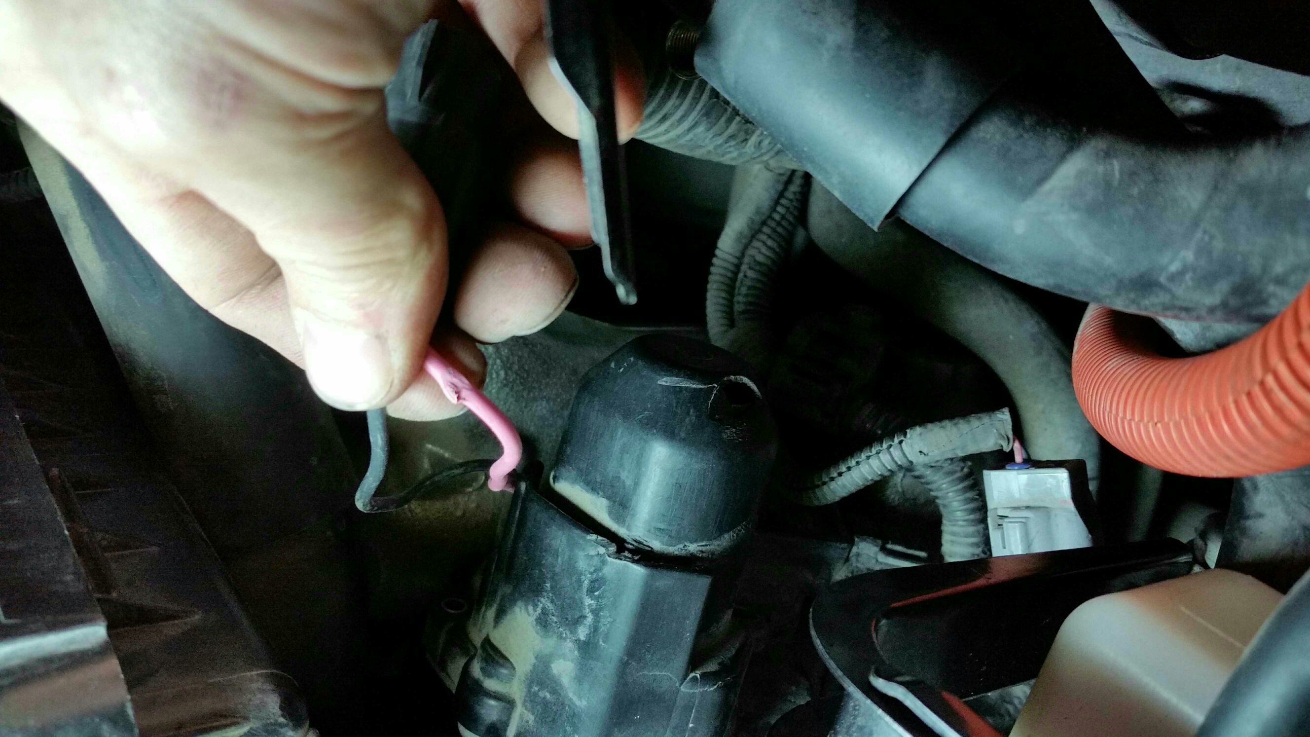

    Found this the boys missed:
    Yes, look very closely the throttle servo housing is cracked open and the pink wite is smashed.

    P1121 Engine Coolant flow control valve sounds like an electric servo thermostat. Most the front end is new including radiator & condenser. Agreed, we filled & blead the inverter both with a professional fill system that bleeds, & used the bleeder provided. Unaware of any additional ICE bleeder but used same filler system. The lower 1/3 radiator is gor inverter and upper 2/3 is for ICE. is there a ICE bleeder screw? If so where?
    Did not like what we saw down past the throttle body so took her off and we did have air cavitating in the body warmer & lines. Also cleaned out some goofs oil overfill mess of about 1/16 inch oil laying in bottom of intake which is why we had some blue smoke right at first starting her when flooring it.
